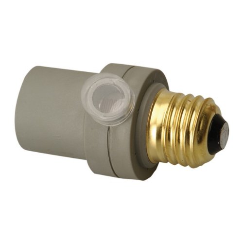

Great information. What if I wanted to leave it running during the day? A "problem" that I have is if I'm in my basement someone could easily be at my front door or garage and I'd have no idea. Part of that cameras job is to give me a heads up someone is at the bottom of my driveway about to enter my property.
As long as the switch at the house is on (and thus the wiring down at the end of the driveway is "hot"), the camera would be running.  Just turn the lights "on," and tape the switch in that position.
The only reason I suggested the photocell sockets is so that your lights at the end of the driveway don't stay on all day...  that's just wasted electricity.
Something like this:

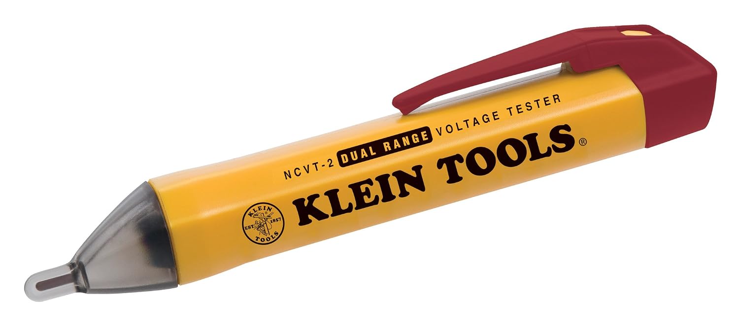

I'll have to get you a photo of said pillar. I'm guessing the power comes up through it and to the light on top. I'm not too familiar with it. As for data storage and being able to view on one TV what do you recommend?
If you wanted to keep it simple, just get something that stores internally... and emails you images.
One of the Hikvision 3MP domes would work just fine for what you need.... and you could trigger it off a PIR sensor.
Get a voltage sniffer to see if the wires down there are hot.  Something like this:  (should be in EVERY toolbox)
