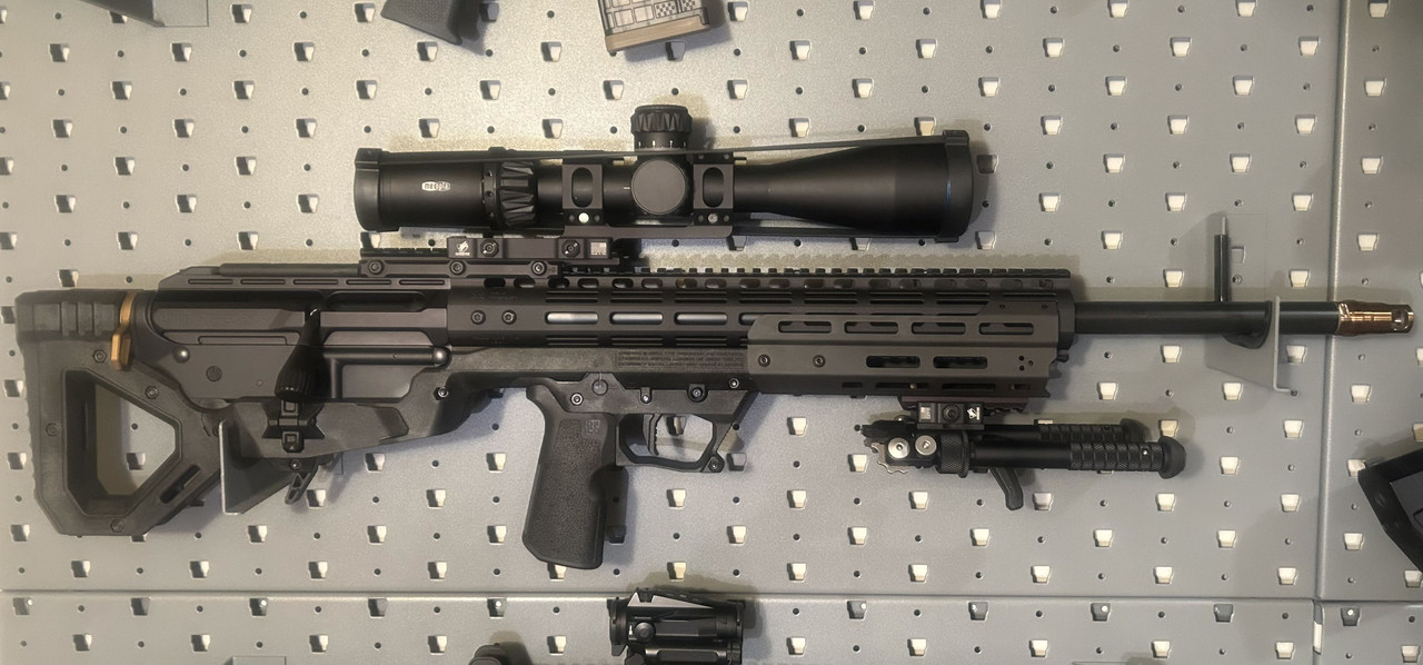

We have SRS at home.
6ARC, 22in barrel.
If anyone is wondering the Daniel Defense rails DO NOT work with the Uintah Precision uppers. Learned that the hard way after I had already took a dremel to the mounting plate...
