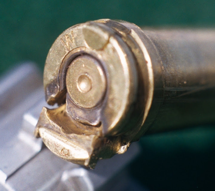

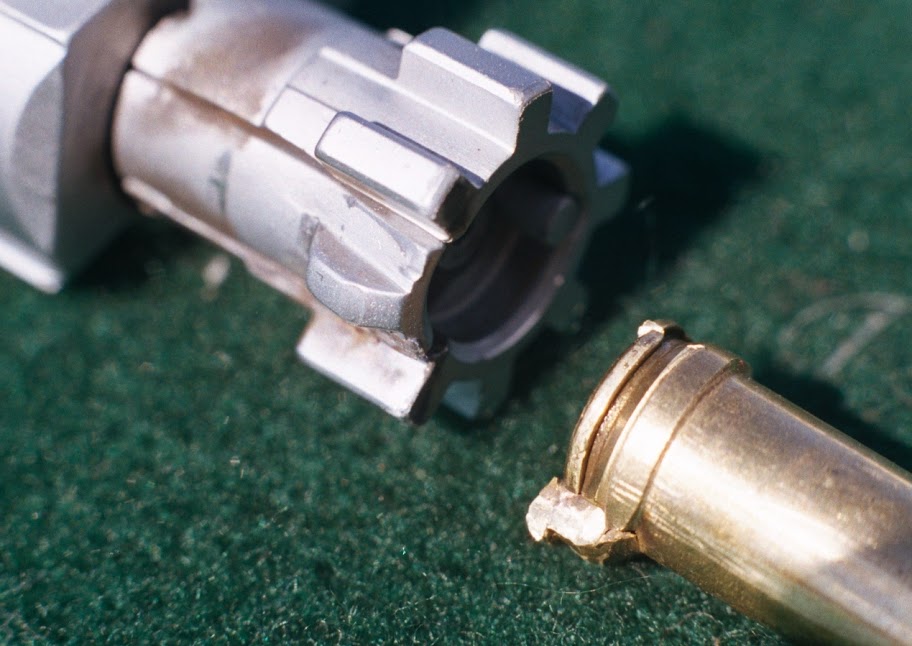

On the USAAUG.com boards there appears to be a trunnion separation on a MSAR. Well here is the thread.

Joking aside he is INCREDIBLY lucky he noticed that. That was a KB waiting to happen. I have never seen that before! even in destruction testing. It does not look like his trunnion was machined to fix the bad casting that was talked about here last week or so. Either this casting had a crack and it somehow got through XRAY screening, it was assembled incorrectly (preloading it with too much stress), or he was using reloads. He claimed he didnt, but who knows. I am astonished at that failure....I spent a good deal of time trying to get catastrophic failures at MSAR....never got anything like that |

Yes the proof rounds could have weakened it, but it should have failed at that point if it were going to. Another over pressured round could have helped that. Like I said these castings are supposed to go through a 100% x-ray inspection. And if it didn't, or it did and the void was missed, then this isn't a fault of MSAR, this is the vendor's fault. I don't think round count had anything to do with it unless there were repeated over pressured rounds going down the tube. The trunnion is held in place by the bushings that the BCG run through. When fired however, the barrel's lugs essentially make the trunnion an extension of the barrel, much like an AR. This explains the failure method shown in the pictures...separation from the bolt's locking lugs back. My money is on a bad casting which should have been exposed on the factory proof rounds. Stranger things have happened though I guess. |

Bean, Yes the proof rounds could have weakened it, but it should have failed at that point if it were going to. Another over pressured round could have helped that. Like I said these castings are supposed to go through a 100% x-ray inspection. And if it didn't, or it did and the void was missed, then this isn't a fault of MSAR, this is the vendor's fault. I don't think round count had anything to do with it unless there were repeated over pressured rounds going down the tube. The trunnion is held in place by the bushings that the BCG run through. When fired however, the barrel's lugs essentially make the trunnion an extension of the barrel, much like an AR. This explains the failure method shown in the pictures...separation from the bolt's locking lugs back. My money is on a bad casting which should have been exposed on the factory proof rounds. Stranger things have happened though I guess. I can say from personal experience that x-ray testing is not an magic tool. I have seen a weld joint get x-rayed twice, by mistake. The first x-ray showed nothing, the second one rejected the weld. It depends on the angle that it was shot, and who is reading the film. If the flaw was to small to see with the naked eye it would be missed any way. I thought MSAR tested a STG556 to destruction and it took 40 poof loads? The bc broke, another casting? I am not a fan of using casting. Looking at the porosity on my STG556 bolt carrier does not give me a warm fuzzy filling. Niether does that pic of the broken trunnion. |

Interesting. An RFB breaks a gas piston, and it is a "KABOOM" An Aug clone blows the locking lugs clear out of the trunnion, and it is a "malfunction"? . Exactly, neither are correct. They are both considered failures on a large degree but a kaboom is never as nice looking as that trunnion separation. If he had been able to fire again with that breakage, that would have been a kaboom. |

Back on topic. This is important for all MSAR owners, round count needs to be determined and I personally would
like an answer from any of the (I count 4) ex MSAR employees about steyr vs. MSAR trunnion composition or manufacture. The relevance of that question is due to MSAR owners opinion of safety and durability based on how long the AUG has been around without catastrophic failure. |
Nobody piggybacks the AUG safety track record to the MSAR. The designs being similar though they both offer the same levels of protection if something does go wrong. This is one guy. One rifle. Out of what 20,000 or so plus? It was only a matter of time before we saw something like this at some point. We've seen FNH FS2000 and other high quality rifles that someone has had a catastrophic failure with. Given time someone was going to do something like this with an STG. |

To be quite honest the receiver/trunnion casting of the A3 looks like shit compared to the MSAR. If the A3 receiver is better made or stronger then the MSAR it is hard to tell from the comparison pictures.![]() MadDog ETA: The A3 carrier looks like it is machined and the MSAR looks cast. |
