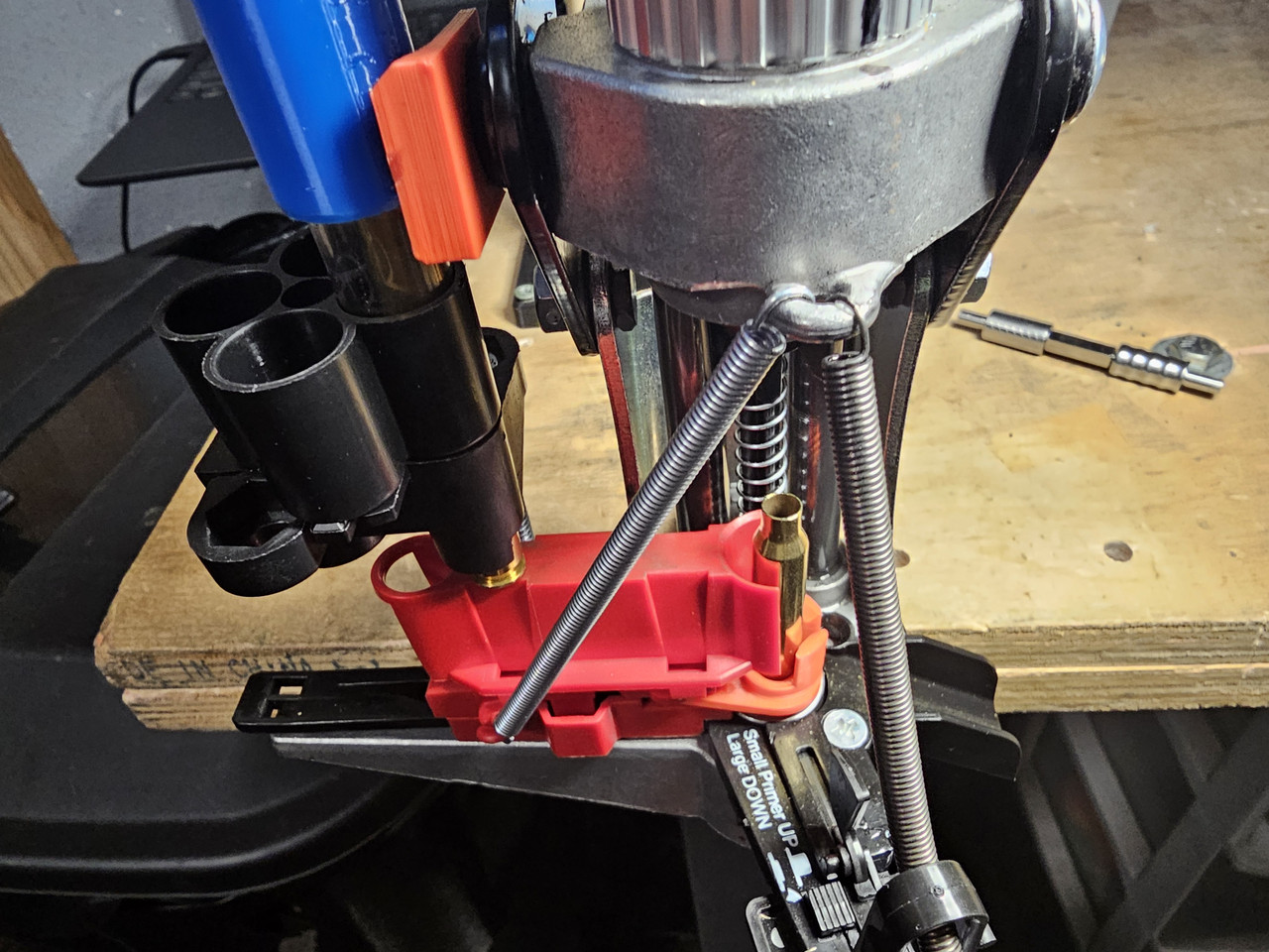

Originally Posted By SG55xdude: Ok great update. The new case deflector and new jaws/feed pawls make a night and day difference. I prefer to watch tv with processing and listen to the radio or podcasts when actually loading. I could not watch tv running the app. Now I don't have to watch the feeding like a hawk. I can just work the handle at a fast steady rate and chug along without a single misfeed at all. So im watching tv to swage the rest. 100% do recommend https://i.postimg.cc/x8mDntHQ/20260403-093243.jpg https://i.postimg.cc/TYrMsNf5/20260403-093247.jpg My feed lips came in yesterday. Got nothing to process however. |
| Yes .223. I can post a pic with a case later. I was just trying to show the installed parts. Swaging .223 is probably going to be 90% what I do with my app. I had to tweak stuff a little but very manageable and really speeds up the rate I can crank through brass. |

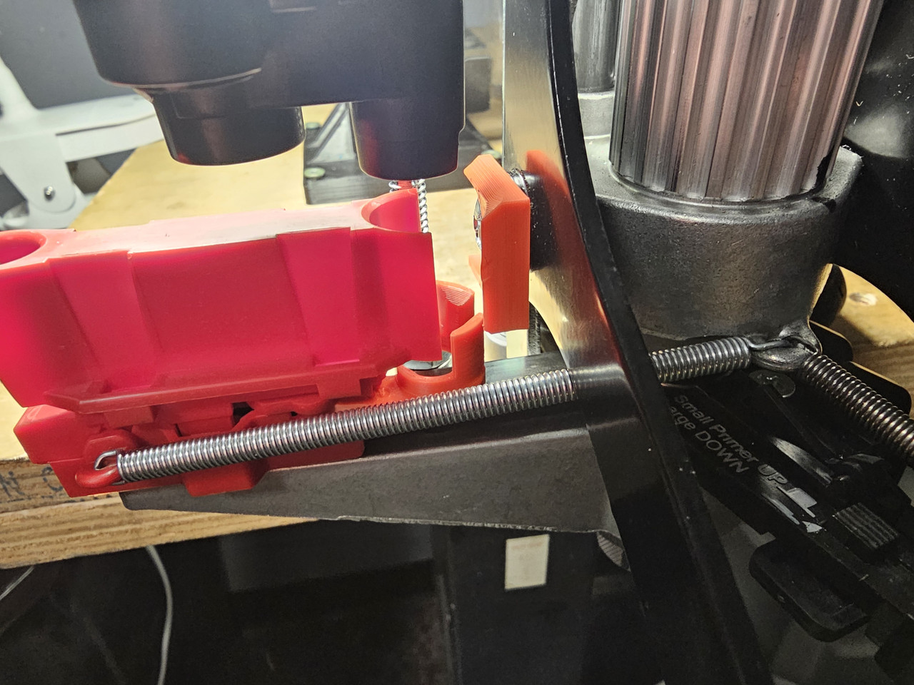

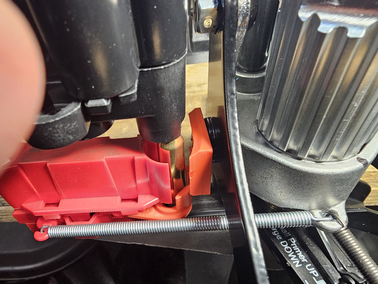

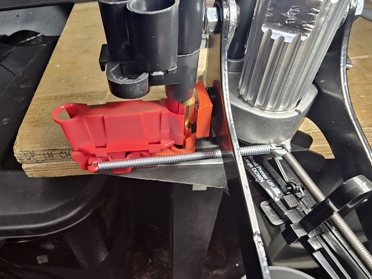

I added the eBay kit in Feb 2025 to help with 223 cases ejecting out of the jaws when cycling. Cases go flying causing me to stop and make sure an unprocessed case didn't land in the finished case bin, then search for where the second case landed. It's my biggest complaint with the APP. The taller jaws helped, but didn't eliminate the issue completely. Slowing the cycle rate helps but it still happens. As far as I can tell, the jaws are closing prior to the new case dropping all the way to the rail the transfer shuttle rides on. Backing out the screw all the way on the back of the shuttle mechanism isn't enough to get the jaws to stay open long enough at the last maybe 1/16"or so when the case drops. More effort required to figure this out. ![]() |
Originally Posted By Blowout: I added the eBay kit in Feb 2025 to help with 223 cases ejecting out of the jaws when cycling. Cases go flying causing me to stop and make sure an unprocessed case didn't land in the finished case bin, then search for where the second case landed. It's my biggest complaint with the APP. The taller jaws helped, but didn't eliminate the issue completely. Slowing the cycle rate helps but it still happens. As far as I can tell, the jaws are closing prior to the new case dropping all the way to the rail the transfer shuttle rides on. Backing out the screw all the way on the back of the shuttle mechanism isn't enough to get the jaws to stay open long enough at the last maybe 1/16"or so when the case drops. More effort required to figure this out. ![]() The bolt that you can adjust the height and position of the case feeding on is pretty crucial. Make sure you have it adjusted so there's just enough room for .223 cases to clear. To much room and you get more misfeeds. To little room and occasionally a case doesn't clear and on the upstroke it binds and then all of a sudden it will launch that piece plus the piece on the ram literally across the room. Also make sure your bench is level. |

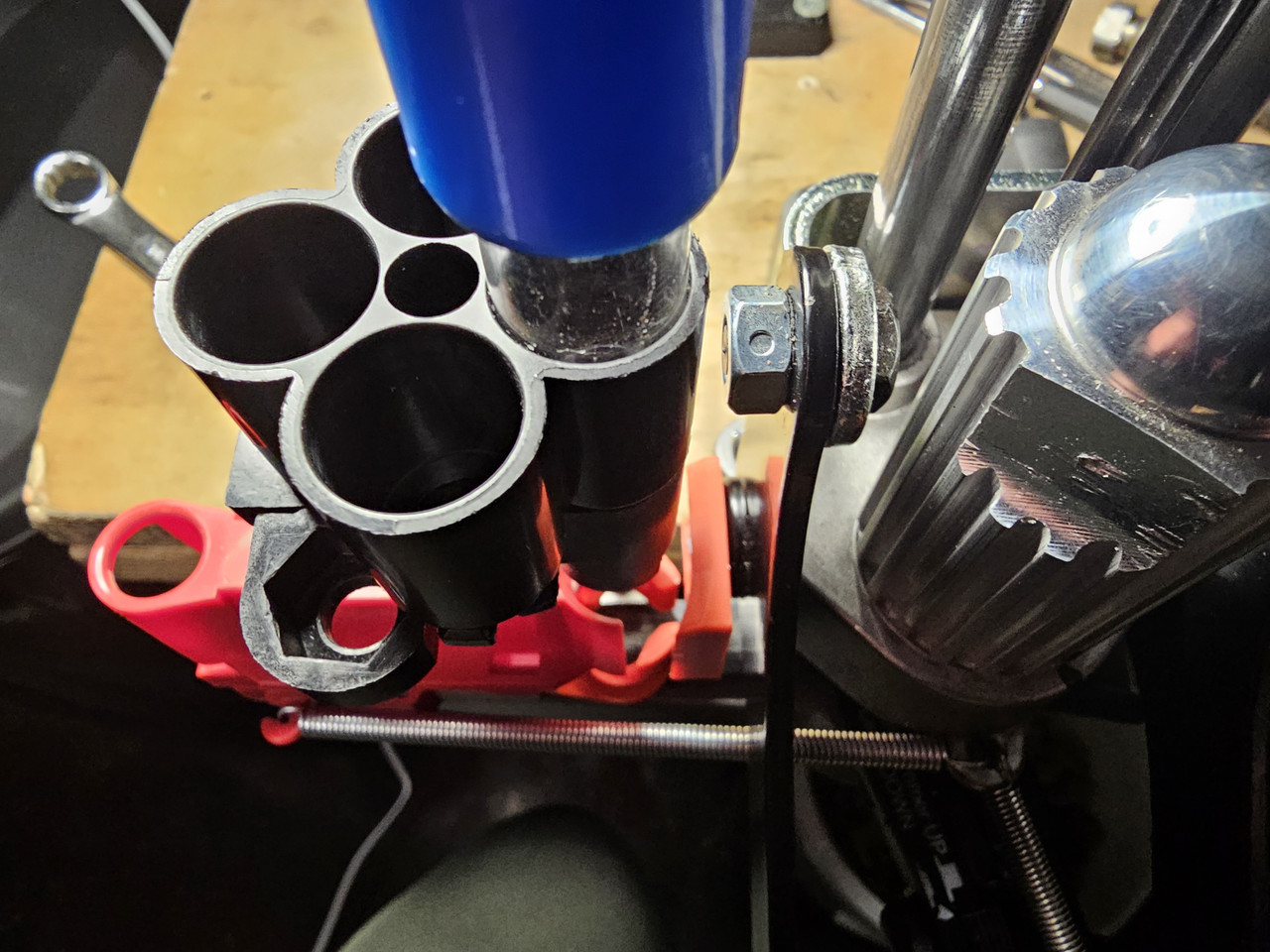

Originally Posted By SG55xdude: The bolt that you can adjust the height and position of the case feeding on is pretty crucial. Make sure you have it adjusted so there's just enough room for .223 cases to clear. To much room and you get more misfeeds. To little room and occasionally a case doesn't clear and on the upstroke it binds and then all of a sudden it will launch that piece plus the piece on the ram literally across the room. Also make sure your bench is level. I guess ram isn't the correct term. The place brass sits whether there's a shell holder or not. |
