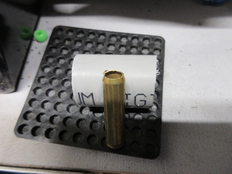

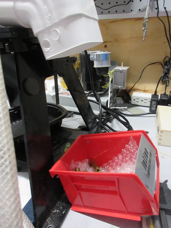

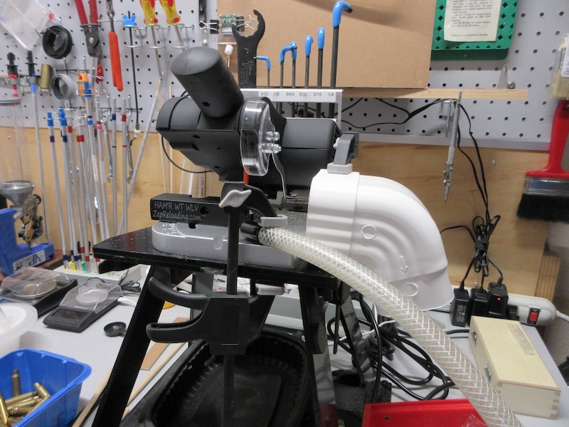

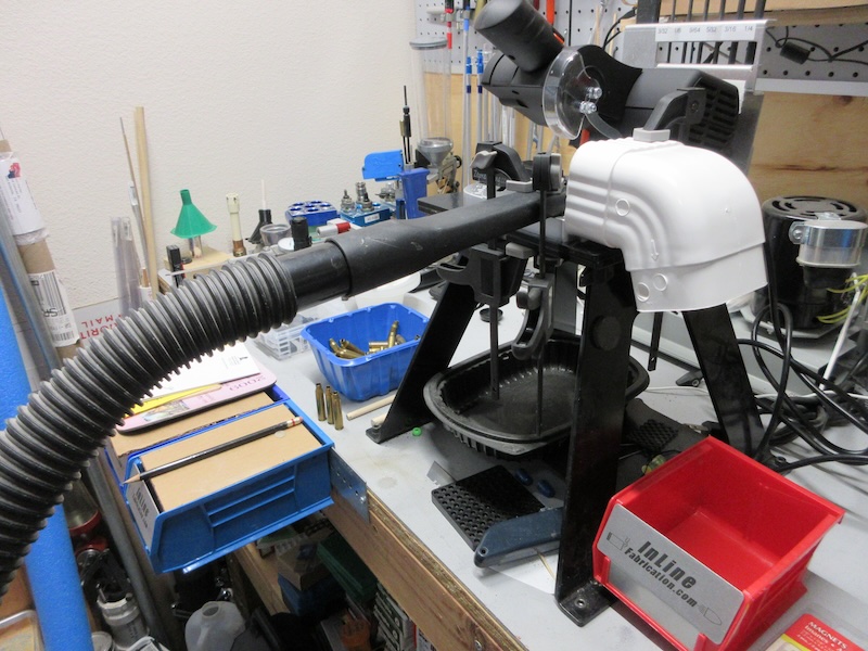

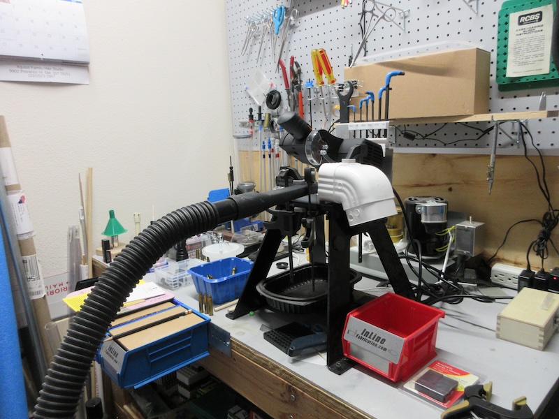

I found that my 300 Blackout cutting jig was not a good choice for 5.45, so I ordered a jig for 300 HAM'R, which is really close to the same length as 5.45. I got it in the mail yesterday, and I have installed it on my new (long story) Harbor Freight mini miter saw. I'm working on how to mount the end of my shop vac hose so I don't have brass chips go everywhere - I feel like I'm close with that but I need to play with it some. Not really overthinking, but more like smoothing out a process: I'm working out how to support my electric screwdriver while it turns cases in the propane flame to anneal them. I'll probably build something from scrap lumber that lets me keep the screwdriver in the right place for every case. I want to be able to concentrate on seeing the Tempilaq rather than am I holding the screwdriver right, is it in the flame right, am I holding my tongue right, etc. For clarification, I use the "spin the case in a torch flame using an electric screwdriver until the Tempilaq changes color" method of annealing (boy do I need a better name for this process). I did a quick check for fit, and a 5.45 case's shoulder is higher in a deep well 10mm socket than where a 300 Blackout shoulder would be, but that should only mean that I keep the torch flame farther from the end of the socket. Also, when I get around to annealing cases may depend on the weather here. It's been kind of hot, but with all the excessive rain we've had over the past couple of weeks, it's pretty humid too. So outside may not be a good choice, and working in the garage may require a LOT more light so I can see the Tempilaq change. We'll see. |
