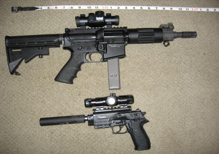

As far as accuracy goes, I shot a...well..let's just say a VERY small animal like the size of a squirrel at 125+ yards yesterday with my 9mm Rock River upper with a Bushnell red dot.
It's plenty accurate.  My friend with me was quite amazed.

My 5" 9mm is so much fun and very very accurate(almost as accurate as my MP5!)

In 9mm, I like the 5.5" suppressed option.
