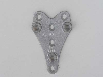

2. Buy the correct RTI "Hanger". You remove all the hardware from the holster backing and replace it with the hanger.
From the acessories page
Hanger:
This particular hanger is the Universal variation one for Safariland and Serpa.

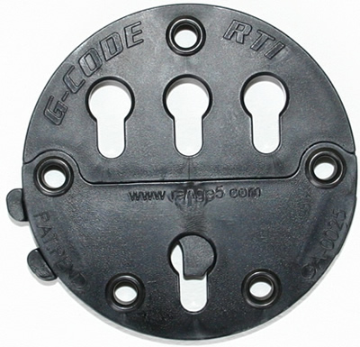

3. The RTI hanger locks into the RTI wheel.
This wheel can be found on several mounting options
Paddle
Belt Slide
Duty Belt Drop
Molle Belt Adapckter
MOLLE Adapter
MOLLE Claw
Drop Leg
There are other multi-platform adapters made by Safariland and Blackhawk but they only work with those brands holsters. The RTI is by far the most universal.
