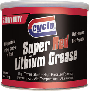

1/31/2013 7:31:28 PM EDT
I just went up and picked up a Gen 4 G19 today and when I was picking up the gun the guy behind the counter told me not to oil the gun but to grease it instead.  Any validity to this argument or was he just blowing smoke?  I honestly have no idea and have never done anything other than oil my pistols.  It would be my impression since I work with industrial machinery, that grease would last a hell of a lot longer than oil.  Anyone ever heard this claim?  What do you guys suggest as far as lubricating a carry weapon?
1/31/2013 7:36:01 PM EDT
I use lithium grease on several firearms including my carry pistols (glock and kimber 1911). Works great.
1/31/2013 7:39:44 PM EDT
DO NOT clean off any copper colored lubricant. Leave it be.
Generally, a Glock will work totally dry, but it should be lightly lubed with a good gun oil... not grease.
look here
BTW... I am a factory trained Glock armorer.(for what it is worth)
1/31/2013 7:56:02 PM EDT
No grease. Glocks like to be pretty dry.
Put some oil on your fingers and rub it on very thin
1/31/2013 7:56:33 PM EDT
I use FrogLube on mine and it's as smooth as butter
1/31/2013 8:05:50 PM EDT
Any suggestions?  CLP, Frog Lube, Rem Oil?  I run Hoppes Oil now and was looking to get something different.
1/31/2013 8:07:36 PM EDT
Use Loctite Copper Anti Seize
1/31/2013 9:05:50 PM EDT
I use Red Lithium Grease from Auto Zone (or wherever) on all my firearms.  Use a VERY thin coat where the manual indicates to lube your gun and on any "shiny" areas where there's metal on metal wear.  Some Q-Tips and a 1lb tub of grease will last you a lifetime for $4. Grease stays put.  Oil evaporates. I like grease.  -shrug-
OR you can buy a "special" Gun-Specific red lithium grease formulation for $6.50 for a tiny syringe...
1/31/2013 10:02:05 PM EDT
DO NOT clean off any copper colored lubricant. Leave it be.
Generally, a Glock will work totally dry, but it should be lightly lubed with a good gun oil... not grease.
look here
BTW... I am a factory trained Glock armorer.(for what it is worth)
We actually have some of that Copper-based anti-sieze laying around so I replace the Copper 'grease' after cleaning.
1/31/2013 11:31:03 PM EDT
I use tetra gun grease on the 4 little rails of the frame.just a dab on finger and rub in. makes the slide smooth when racking the gun.
2/1/2013 3:39:35 AM EDT
I use Brian Enos Slide Glide on mine. Does make it feel smoother. You have to be careful not to put to much on though and it can make it slugish.
2/1/2013 3:48:16 AM EDT
I use Brian Enos Slide Glide on mine. Does make it feel smoother. You have to be careful not to put to much on though and it can make it slugish.
This does work VERY well.
I've tried oil & grease.  Either works just fine.
2/1/2013 2:32:54 PM EDT
I use tetra gun grease on the 4 little rails of the frame.just a dab on finger and rub in. makes the slide smooth when racking the gun.
Same here. I use CLP almost exclusively on all my guns, but I put a little Tetra gun grease on the frame rails.
2/1/2013 2:46:26 PM EDT
I use TW25B (light grease) and have no problems; do not over-grease or over-lube a Glock.
Read the post next to last in this thread. Running a Glock dry or near dry is foolishness, unless you're into premature wear.
2/1/2013 2:56:48 PM EDT
Small bottle of Rem Oil with a built in dropper. 4 drops of oil is all you need.
2/1/2013 3:01:17 PM EDT
Maybe the older Gen 1,2, and some older gen 3's didn't need much lube. With the new BTF, and FTE problems with gen4 and some Gen3 Glocks maybe it is time to rethink the lube situation on the newer Glocks IMHO.
2/1/2013 8:55:22 PM EDT
You really dont need to lube that much, like in manual.  I use good ol Amsoil.
2/1/2013 10:37:14 PM EDT
Maybe the older Gen 1,2, and some older gen 3's didn't need much lube. With the new BTF, and FTE problems with gen4 and some Gen3 Glocks maybe it is time to rethink the lube situation on the newer Glocks IMHO.
NO.
2/1/2013 10:53:20 PM EDT
i use slipstream i use grease on the rails and oil anywhere  else i love this stuff and give it away as gifts to my gun friends on birthdays . any one i know who uses it never has anything bad to say and in fact most cant stop talking about it . it can also be found on amazon now so if you have gift cards left over from the holidays grab some
2/2/2013 12:02:37 AM EDT
I use Brian Enos Slide Glide on mine. Does make it feel smoother. You have to be careful not to put to much on though and it can make it slugish.
This does work VERY well.
I've tried oil & grease.  Either works just fine.
Slide glide lite works great on all my pistols.
2/2/2013 1:22:53 AM EDT
No.
2/2/2013 4:27:21 AM EDT
I usually assume that the guy on the other side of the counter would be on my side of the counter, if he were as smart as I.
2/2/2013 4:33:12 AM EDT
i'll stick with Break Free CLP or Slip 2000.
2/2/2013 4:45:53 AM EDT
I put a light coat of copper grease on the rail contact points on the frame and the slide channels.  Just a light dip with the skinny end of a cleaning brush to deposit a light coat. I kept finding that oil and clp failed to stay where it needed to be on those contact points.
2/2/2013 8:50:42 AM EDT
Mobil 1 5W 30.  Militec 1 also works well.  I don't use grease because I sometimes shoot in cold temperatures and it will slow things down.  Indoors or in warm weather doesn't matter so much.
2/2/2013 9:01:04 AM EDT
A little bit of CLP is all I have used for years.
2/2/2013 10:08:19 AM EDT
I use TW25B on the rails and CLP on the rest.  Pick a lube and use it.  Just because a Glock can run dry doesn't mean it should be.
TS
2/2/2013 11:11:58 AM EDT
The Glock has very minimal lubrication requirements and grease is not one of them.
2/2/2013 8:00:32 PM EDT
I've used CLP and motor oil.
2/2/2013 8:37:38 PM EDT
A little dab of industrial extreme high pressure grease (rubbed in with my finger tip) on the barrel and rails, and a drop of CLP in the frame
has served my Glocks well.
"A little dab'll do you."
2/2/2013 11:51:51 PM EDT
a 43 second video lets you hear it for yourself slipstream is the way to go madogre
2/3/2013 5:59:13 AM EDT
a 43 second video lets you hear it for yourself slipstream is the way to go madogre
Watching a clerk at a gun store cycling the slides of Glocks didn't convince me of anything.  Try the same comparison, using Mobil 1.  Slipstream is probably just another "firearms specialty" snake oil that in no way competes with the lubricity properties of Mobil 1.
2/3/2013 9:26:54 AM EDT
TW25B  MILCOMM
“I use Mil-Comm to maintain my pistols.”
- David Sevigny
or
XF 7 maxpedition
2/3/2013 12:44:57 PM EDT
Whatever you use, use half the amount you think you need. Over oiling just attracts dust and lint and turns into a greasy mess
2/3/2013 6:30:29 PM EDT
Don't clean off Anti Seize.....please! What the hell is this crap?,......since when people started using this crap for lub to put back on their glocks!
Shit...since 94 I've been ONLY using CLP, and NEVER HAD ANY PROBLEMS......AT ALL! I guess I should go to auto zone and get some anti seize!
2/3/2013 7:42:09 PM EDT
Do what ever makes you happy. I get kidded a lot because I tipically over lube all my guns. My glocks drip oil and  grease all the time. I have fired thousands of rounds out of them with not a singel problem.  I've also run my old G17 dry for years and no problems  there either. Do what makes you happy.
