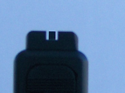

Iam constantly shooting low with my 17 gen4 .about 3 to 4" low at 10yrds
with my 23 I stilll shoot low but not as bad is it something iam doing or am I using the wrong sight picture ?
should the dot be above the U or inside the U.I had a thread up about it before but I cant find it .

Equal light and equal height.
4/9/2011 4:09:47 AM EDT
@Jesse: These are not the stock sights, which i believe the thread opener is using (keywords: dot, U)
the dot is in the Center of the U.
POI is the upper edge of the dot.
(at least, this is the case with my G17Gen4)
4/9/2011 4:27:06 AM EDT
The paint doesn't matter. the pic posted above is the proper sight picture. The 3 dot, U-dot or any other configuration only help to speed alignment in theory and in daylight conditions. Regardless of what is drawn on the sight you still have to center the front post in the rear notch with the tops of all 3 on the same plane. Painting over the whie crap might even help you.

With my gen3 G23 I cover the Target with my front sight. Stock sights.
4/9/2011 9:22:38 AM EDT
This. Stock sights offer what I think is called a "combat sight picture" meaning you put the sights directly over what you want the bullet to hit. I noticed the same thing on my Gen3 G17.
4/9/2011 2:39:49 PM EDT
ok ill try that the next time I go to the range. now what would a taller front sight do ?thanks
4/9/2011 5:29:52 PM EDT
Taller front sight will shoot lower because it drops the muzzle.  Are you using to much trigger finger?  Check your grip?  Have someone else shoot it and see if it shoots low for them.
