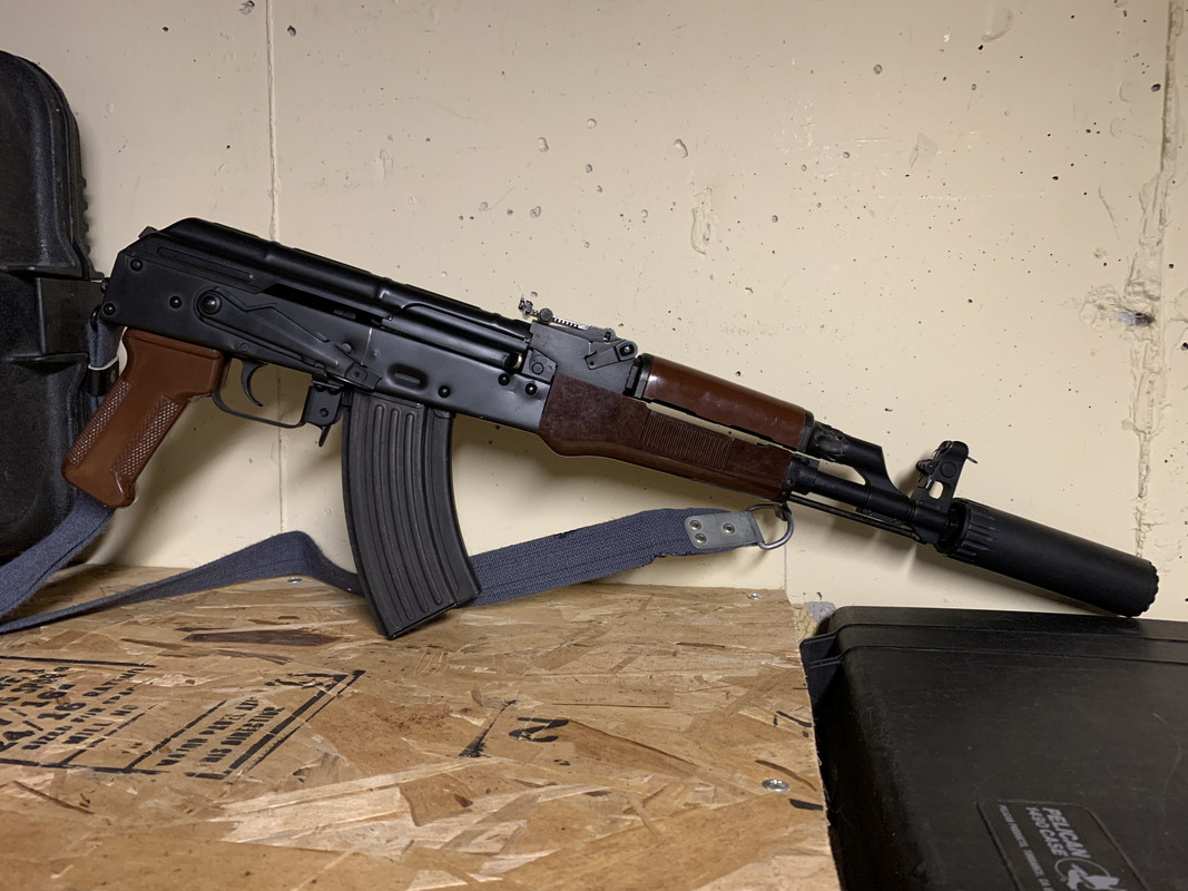

Zastava PAP chopped to pinned to 16 with rugged 3 port - rugged radiant on the end Attached File |
