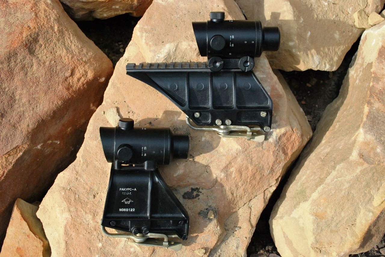

You could also try Rakurs A1 or Rakurs-PM
http://russianoptics.net/Rakurs.html
Though I used the PK-AS for many years and considered it the best of the combloc optics, IMO Rakurs is superior to PK-AS.
Easier to zero, very similar optical quality, always on german post with tritium illumination and it's also built like a tank. Rakurs looks heavier but weight is actually nearly the same, PK-AS at 15.8oz and Rakurs at 17.7oz. I'm of the opinion that the NPZ clamp is the best design for a side rail optic and while there's nothing wrong with the SVD style mounting system the NPZ has a greater tolerance for differences in rail design or manufacture. It's also easier to get the tension dialed in.
1P76 on bottom, Rakurs-PM on top
If you want to get really space age check out Obzor. After months of regular use it's now become my favorite red dot / collimator. Several members like LiquidMetal have been using Obzor for a long time and have great things to say about it as well.
