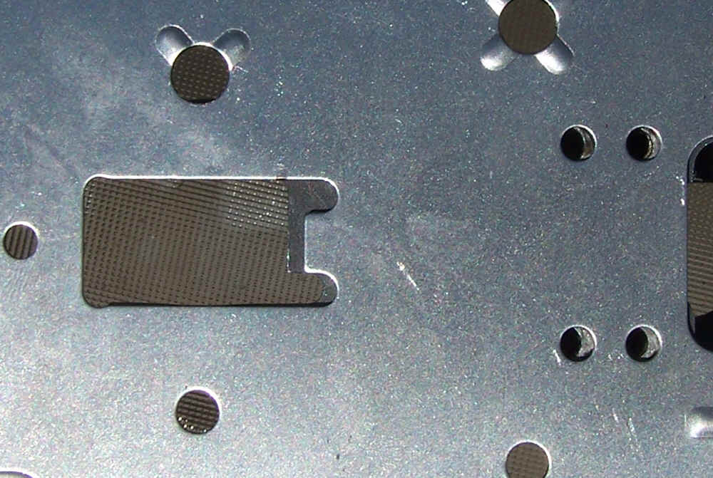

6/7/2007 4:11:29 AM EDT
This is one of Tapco's new flats. As you can see, the TG holes are still pooched.
6/7/2007 2:42:41 PM EDT
well go and buy the Correct flats from the real builders and make sure to buy the optional reamers to fix the holes when your done. and the optional correct center bushing for $$$ also.  I will be shooting my ak meanwhile.

Tapco flats will work, there is no question about that. I have built many AKs using them. So have many, many others. For a long time they were the only game in town for flat builds.
All I'm saying is that there is a better option available now.
I don't know of anyone who has built on both, who will not agree that the AK-builder flat is more in spec than the Tapco. Not to metion the fact that AKB has many more models available. Besides his standard 47 flats, I have also done builds on his 74, Tantal, Polish UF and M92 flats. All were dead nuts on.
