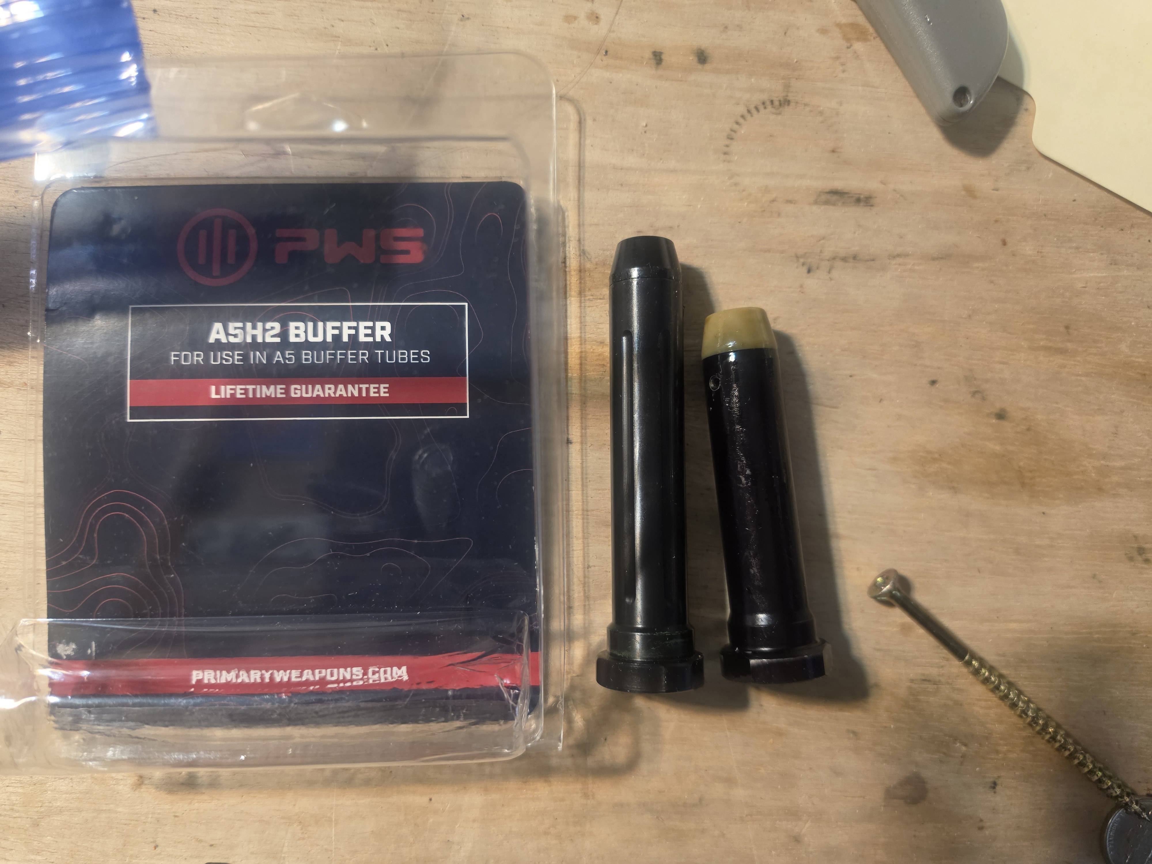

I'm pretty sure it's the right one.  Here's a pic, the new one is on the left.  Can you confirm that it's safe to run with a quarter?  I don't see any reason why it wouldn't be, but some feedback from those with more experience would be greatly appreciated.
6/5/2026 9:48:53 PM EDT
Looks right.
I have never used quarters because of their uneven surface. I ordered some thin washers with a small bolt hole for the drain and used them a couple of times. I used them because the tubes had wide angle divot in the bottom that wasn't supposed to be there not for a spacing need.
