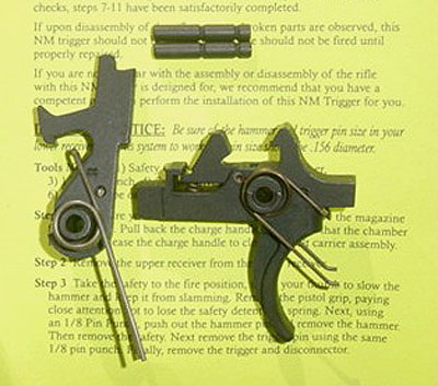

Look at the photo I added to this post.   the trigger shown in each group only works with that hammer shown in the same group .
In the photo's of yours with parts installed, you have a standard (non NM) hammer with a NM trigger and it ain't going to work with these parts installed that way.
So leave the NM trigger in the receiver, pull the standard hammer out, install the NM hammer back in, and all will be good in the world.
Standard FCG  and it's parts,
NM FCG, and its specific matching parts,
so again, each hammer/trigger/disco has to be used with it's own FCG specific parts alone and not swapped between the two or another NM Fire control group.
The standard selector, it's detent, and the detent spring work for both shown fcg's, so you can use those in either of the groups shown.
