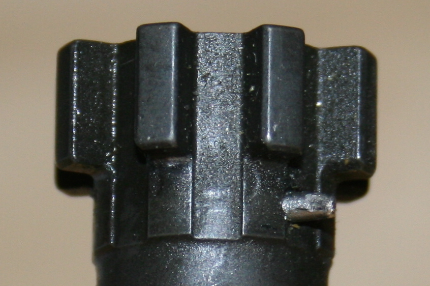

So I was just going to remove the ejector from my new bolt, so I could carefully check how it headspaced with a new barrel.  No problem, right? I've done it lots of times.  Well things went wrong.

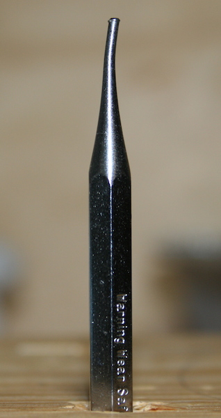

It looks like first, the tip of my punch (yes, the right size punch: 1/16") wasn't smooth, so it got jammed in the roll pin hole.  Second, my Brownell's Ejector Removal Tool slipped as I whacked the punch, and both the tool and bolt moved away from me as I was striking the punch.
(The bolt isn't that rough, it's just not all cleaned up and oiled because I degreased it before starting to work on it.)
So I have a new bolt on the way, due Wednesday.  I have failed at trying to remove the stuck end of the punch.  It looks rounded because I tried to grasp it with pliers, and they just chipped or slipped and rounded it.  I tried pulling out the exposed part of the roll pin, but that didn't work either, and I haven't been able to make any headway in drilling it out.  So now I have a frustrating and expensive souvenir - and several spare bolt parts.
I examined the rest of my punches after this happened, and most of them seem to be at least a little "mushroomed" from use.  They're all Craftsman tools, and old-style Craftsman tools at that, so I may be able to get them replaced under the old-style Craftsman warranty.
Why did the Ejector Removal Tool slip?  Probably because I hadn't set it up squarely on my bench before I started.  So it looks like I used a damaged tool and didn't set it up in the fixture properly, so I borked a perfectly good bolt through not taking my time and not inspecting my tools before using them.  Lessons learned here, dammit.
Please check your tools before you use them.  Please take your time, even with a task that should be trivial.  And please don't laugh at me too much...  I'm only starting to laugh at myself over this.

Just get a new punch and drive from the other side....I really only use the vise for installing ejectors...Just use a bench block to pop 'em out.....
8/3/2014 7:26:24 PM EDT
One option is to grind down as much of the punch protruding from the bolt as possible, and then using a hydraulic press to press the remaining punch material out.
Thanks for the suggestion, but I tried that.  I even let it sit with Kroil overnight before I tried.  I may not have had it well supported when I tried the first time, so I mocked up a support out of a wooden block with a generous relief hole and I didn't budge it, and my new punch tip got distorted with my attempts.
I'm taking up the earlier guy's offer to take care of it for me, and hopefully it won't be as borked as I was worried it was.

you may actually be hitting on the side of the ejector itself. Take a piece of brass and hook it under the extractor and press it back against the bolt face and gently try it again.
8/4/2014 5:17:15 PM EDT
Had a bolt once that the ejector pin was installed incorrectly and was mangled inside the bolt. It had never started through the other side of the bolt when it was originally installed. Wound up trashing the bolt because I could not figure any way to get the bent up pin out.
Did the pin ever start coming out the other side?
8/4/2014 5:51:04 PM EDT
I kind of thought that might have been the case, but I just gave up instead of getting even more frustrated.
