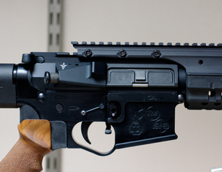

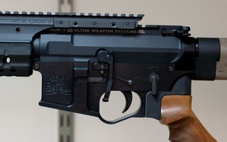

I put betty boop on mine and gave it to my wife.  Put the typical other stuff on too, initials, bday serial number and town.
<a href="http://s1048.photobucket.com/user/mohabie/media/pewpew/IMG_20131224_200712_745_zpsb5463370.jpg.html" target="_blank">http://i1048.photobucket.com/albums/s374/mohabie/pewpew/IMG_20131224_200712_745_zpsb5463370.jpg</a>
<a href="http://s1048.photobucket.com/user/mohabie/media/pewpew/IMG_20131224_201445_177_zpsd78da14a.jpg.html" target="_blank">http://i1048.photobucket.com/albums/s374/mohabie/pewpew/IMG_20131224_201445_177_zpsd78da14a.jpg</a>
Who did the work... and how much did it cost?

East coast custom tactical.  In Florida.  $230.

Dude, the rear MBUS on that rifle is on backwards.
