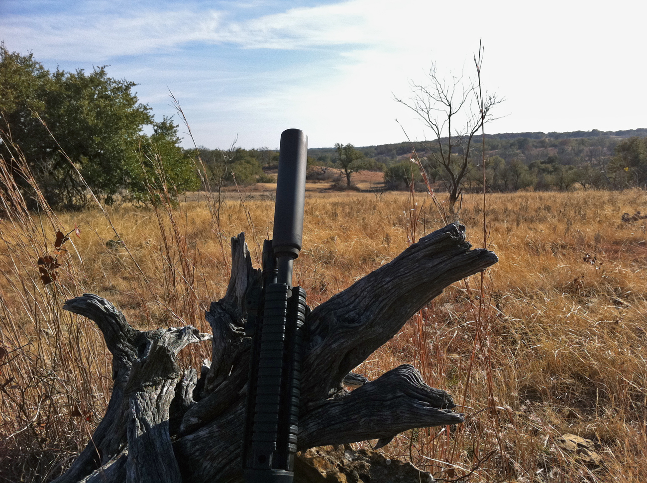

Definitely look for match barrels, BCM's SS410 are another to look at.  I've got a 11.5" stainless from globaltactical (used to be a sponser) - made from a douglas premium blank and machined at compass lake engineering, very accurate with premium ammo.  I load 95% of my match ammo, which is always a plus when going for all out accuracy.  2 loads are 20 rd ragged hole accurate, and even my budget loads (using prvi 75 bthp - they vary a lot) I'm good out to 600 meters, if the wind cooperates.
can't see the 10" plates, which are 230 meters or so out -
