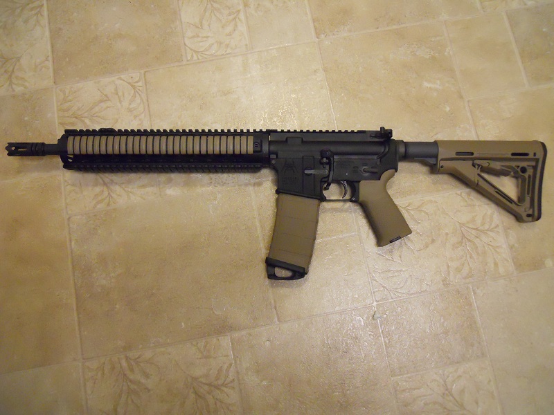

3/1/2012 9:40:57 AM EDT
Barrel and brake came in! I did decide to go with the Phantom 5c2, thanks airgunner for the suggestion. Larue index clips came in. Expecting vert grip and gen 2 mbus to arrive this afternoon, but knowing USPS, I'm thinking it will be tomorrow.
Gas system and magpul triggerguard are supposed to be delivered tomorrow afternoon.
ETA -
I've got my eye on a Vortex Sparc in the EE, and come Monday if it's still around, it will be mine. Going to a buddies on Sunday who has vice + upper rec. block, so I can torque down barrel nut.
Weighing in right now at 6lbs 2.5oz. Heavier than I'd like, but with rifle length diamond handguard, I expected it.
http://www.underthewood.net/images/rifle02.jpg

3/3/2012 12:27:52 AM EDT
Double post, kill me.
Rifle finally has all necessary parts to function (spare the ammo). Day after tomorrow it gets completely finished. This picture illustrates some changes since last picture. Vert grip, which I am liking. I"d like storage, so I'll probably switch it out accordingly. I'm also considering getting rid of the large charging handle in favor for a medium or small. I intent to run a light chest rig on top of a plate carrier, but 6 mags only, so I'll have to see if/how it interferes with gear.
Weighing in at 7lbs 9oz.
Picture also shows MOE trigger guard. Gas system is installed also, but for some reason the roll pin split in 2 when I went to tap it in. Hopefully my buddy has a spare when I finish up on Sunday, but I've already got a few of them on order.

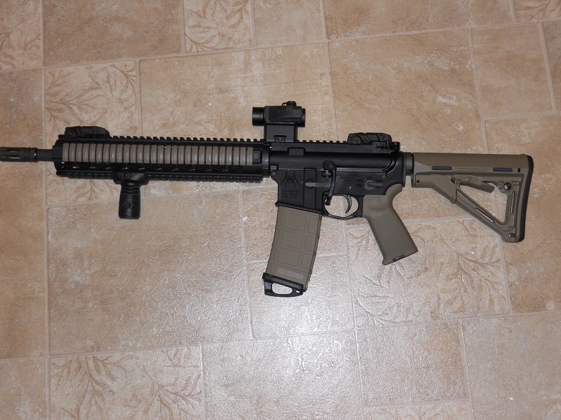

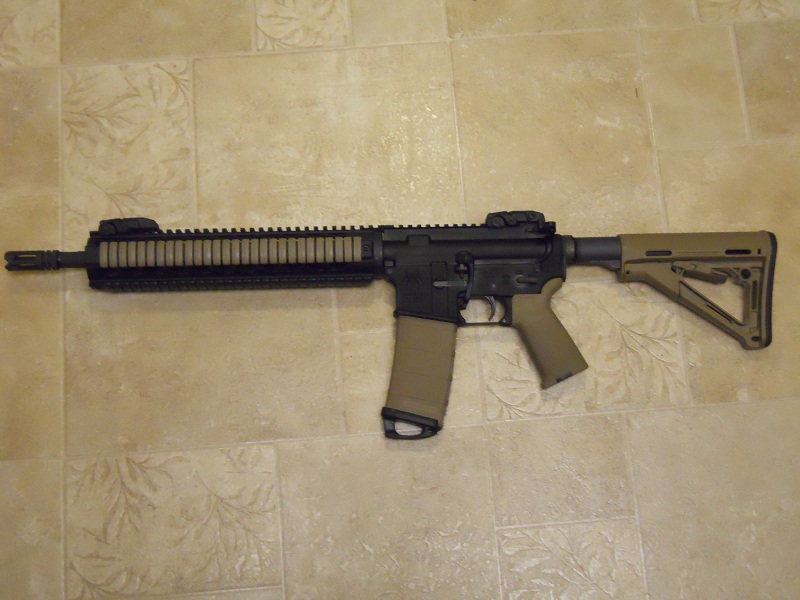

3/4/2012 1:59:29 PM EDT
Triple post, I'm on a roll
Final assembly finished. Didn't get a chance to sight in, but function tested well. There was an issue cycling on the first go around, but I believe that was either misaligned gas block, or not completely tightened down. Either way, it was fixed and cycles fine now.
I thought I'd post my list of parts + relative prices, in case like me, others find it difficult to get an semi accurate estimate of prices.
Complete parts cost
This list does not take into account the fact that I had a buddy with a vice and upper receiver block. I also was able to find some parts for a little less (or were gifted to me) but were less than new. Example, torque wrench worked great to tighten the barrel nut, but it's stripped and cannot loosen something. My forearm wrench takes care of that, so it wasn't a big deal. Saved $20 on it though.
Oh and, 500 rounds ordered for testing :D
ETA - Optic In
