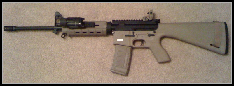

I don't think anybody makes a kit as light as I wanted. Here's my take on lightweight. Not sure if I can make it any lighter without removing the bayo lug and sling swivel.

...Not sure if I can make it any lighter without removing the bayo lug and sling swivel.
And flash hider
