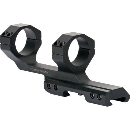

5/10/2012 7:26:01 AM EDT
Stay away from ALL NCStar products. They are not even suitable for airsoft, BB guns or paint ball guns.
Check out the Vortex Optics Cantilever Mount. That is one nice looking mount.
5/10/2012 7:40:58 AM EDT
Yes that IS nice. Thanks for the heads up on NcStar stuff. I guess you should only go so cheap.

Which ever mount you go with, I'm sure you'll appreciate having a cantilever mount. Cantilever mounts allow you to mount your scope in a more forward position therefore giving you proper eye relief.
I used to have standard rings and the ergonomics drove me nuts with regard to improper eye relief. I switched the rings out for some cheapo mount. I could tell it was crap, but it did help with the eye relief. I then switched it out for a LaRue mount and I was hooked for life!
Good quality mounts have generous ring spacing (which supports the scope properly), a longer base (that attaches to the rail) and are absolutely rock solid (no flex). If you compare some of the inexpensive mounts you'll see that most of them have close ring spacing, a short base attaching to the rail and are likely not designed to be rock solid. That cheapo mount I was talking about earlier ... I could push on the objective lens of my scope and see that either the mount and/or the scope was flexing. Likey due to lack of proper ring spacing for a solid hold on the scope (allowing the scope to flex) and/or the mount itself was flexing.
Believe it or not, but there truly is a reason why these mounts cost what they do. I've come to accept it and have embraced quality when it comes to firearms. I've seen soooooo many cheapo optics fall apart, cheapo lasers lose zero, cheapo mounts not do what you expect them to, etc . . . That's what "buy once cry once" means. You will not regret buying a decent mount. Save up and you WILL be happy in the end.

Those new Vortex mounts look great. I could'nt find a 1 inch model though? only 30mm?
It would appear so from their web page at least at this point in time.
