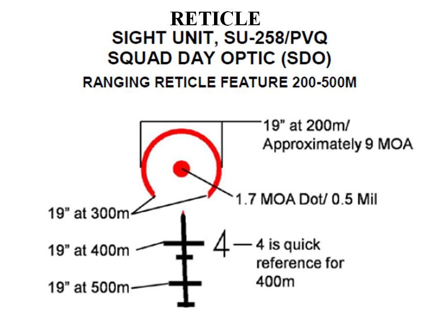

Just looking to confirm my understanding on the difference between the standard TA31F and the RCOM4.  If I'm not mistaken, the only difference is that the RCO has horizontal stadia in the reticle, killflash and tethered caps.  Can someone confirm, and if possible comment on the value (or lack thereof) of the horizontal stadia?  I'm not sure when any of us might need such a thing, but it doesn't hurt to ask the question.

The horizontal stadias are actually MIL marks, for calling for fire, and such. Really helps the Forward Observers and such.
I wanna say the distance between each horizontal stadia is 5 mils if I remember correctly from the TM for the optic.
The only difference between the TA31F and the RCO is indeed the addition of tethered caps, killFlash, etc.

Refer to the BDC above.  The subtle variances in vertical stadia show how the difference in barrel lengths affect POA.  If my understanding is correct, the center (black) stadia are for a 16" barrel; the M4 stadia at right (purple) is for 14.5/7 and the A4 stadia (green) is for a 20" barrel, so you can see that while there is a difference, it's not much.   I'm curious about the horseshoe reticle myself, but there didn't seem to be a lot of feedback on the pros/cons of it, so I went with the chevron.

Here is the TA-31RCO manual:
To adjust deviation, multiply OT factor by the number mils distance between the target and where the artillery round splashed.  This will give you the adjustment in meters.
OT factor = distance in meters from Observer to Target (OT) divided by 1000m
It is 10 mils from the point of the red chevron to the first hash mark to either side, then 5 mils between each horizontal hash mark.
