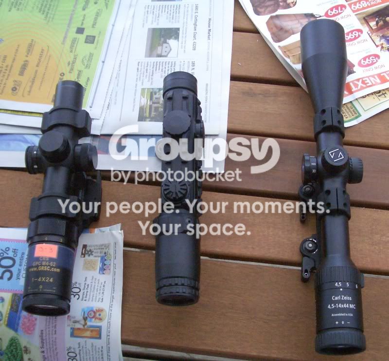

Review comparing USO SN-4S, Horus Talon, Trijicon Acupoint (1.5x model not the one in this thread), and the S&B short dot (non zenith I believe). Originally posted by C4IGrant on M4carbine.net
Original post can be viewed here
I have the privilege of having the USO SN-4, Trijicon Accupoint, Horus Talon and the S&B Short Dot in my possession. I have spent some time with each of these optics and have come to some conclusions about which is the best. Here is a three up and three down review of each:
USO SN-4
Up
1. Chevron in circle reticle
2. Glass quality
3. Ranging capability
Down
1. Cost
2. Weight
3. Illumination not visible in full sun
Trijicon Accupoint
Up
1. Cost
2. Triangle reticle
3. Eye Relief
Down
1. Not 30mm
2. No ranging
3. FOV
Horus Talon
Up
1. Cost
2. FOV
3. Ranging reticle
Down
1. Illumination not visible in full sun
2. Reticle very busy
3.
S&B Short Dot
Up
1. FOV
2. Controls (pull out on knobs to turn & release to lock again)
3. Illumination visible in full sun
Down
1. Cost
2. Weight
3. Reticle not visible on 1X (not necessarily bad)
Only the Accupoint and S&B have visible illumintation in full sun. This gives them a big advantage IMHO. The Talon is just as good as SN-4 for almost half the price. The Accupoint still remains the best bang for the buck.
The S&B is now my new favorite. The first 6 postions on the illumination dial are for NV. Position 7 gives you a visible dot on a cloudy day or indoors. Postion 8-11 are visible in full sun. The great thing about the illumination dial is that you don't have to go back to 0 to turn the dot off. Just go between a number and the dot shuts off!
On 1X the reticle really isn't all the visible. I at first found this to be a negative, but then began to think about it. If your running on 1X your most likely in a CQB environment and would be using the illuminated dot. The fact that you don't have the black reticle cluttering up the glass is a good thing IMHO. In 2-4X the reticle is precise and useable. The windage and elevation knobs feel precise and I like that you pull them up and then turn to make adjustments. This does away with the need to have caps over them (smart).
S&B on 1X
S&B on 1X with illumination
S&B on 4X with illumination

My review of the new Korean GRSC 1-4x scope from Ed Verdugo
Today I have in my hands for review a GRSC 1-4x scope from Ed Verdugo. We’ll get to the scope shortly, but first a few words about Ed and how this scope came to exist. Ed is a former Special Forces operator who, since retiring from the armed forces and becoming a fireman, has dedicated much of his hobby time to improving our war-fighters’ gear. No doubt you have seen (and probably used) one of the many receiver endplate sling attachment points he invented. You have probably also used a sling that borrows at least a few of his innovations in that department. A few years ago, Ed became interested in improving our troops’ sighting systems. He designed, and has subsequently improved upon, a combat reticle. He has since attempted to have that reticle included in a combat-worthy scope, with varying degrees of success. At least three scopes on the review table at the beginning of this thread have all or part of Ed’s reticle design in them. This particular scope is one that not only has Ed’s reticle, but also is manufactured for and sold through Ed at GRSC. He has put much of his own treasure on the line to bring such a scope to pass. For a guy with seven kids and an ex-wife, that cannot have been easy. It is notable that this is the second scope Ed has had manufactured using his reticle and more models from different manufacturers are likely to come. Originally there was an unsatisfactory Chinese GRSC scope made by Millet for Ed. The one I am reviewing here is a Korean manufactured scope just now entering production. Though the scopes use very similar reticles and appear superficially similar, they are not at all the same scope. Completely different companies were used in their manufacture and the Korean version is of substantially better quality.
As is noted in many of my other reviews, few 1-(n) power optics have a reticle that realistically offers a high speed and high hit probability over that full range of engagement distances. A 5.56mm assault rifle is a very effective close quarters tool, but is also effective out to a full 800 yards. This is provided the user knows how far the target is and where to point the gun. Many optics use close quarters reticles like circle dots that are fast up close but limited to an effective range of 400 or less yards. Other optics use mil dot type reticles that are not particularly fast up close or at range. Though capable of estimating the range of targets, mil dots require mathematical calculations to accomplish this. They further require the user to adjust the turrets to compensate for range and drop once the calculations have been made. Though this might be a serviceable, if needlessly laborious, procedure when engaging targets that are unaware of the user’s presence, it is not a viable option when the targets have already engaged the user. No one is going to pull out his calculator in a firefight. To be honest, I am no longer convinced that mil dots even have a place in sniper scopes, let alone in close quarters optics. I believe that the mil dot is a once innovative but now antiquated idea that persists largely due to lack of creativity on the part of manufacturers and lack of knowledge on the part of the consumer.
The reticle in this GRSC scope is one of the few reticles designed to accommodate both close quarters and long-range engagements and is available in the 1-4x scope class. It has features for snapshooting, ranging, bullet drop, windage, and moving target leads. Allow me to walk you though the functions so that you will understand how it works. Please refer to the close up image of the reticle (below) while reading this section. I promise it is not that complicated and is well worth understanding. The large central horseshoe that surrounds the 100-yard zero point has an inside diameter of 10 MOA. This corresponds to the size of a human head at 100 yards and serves to range that distance. The horseshoe is a massive 4 MOA thick. This is so that when dialed down to 1x, it will appear as a dot for close quarters combat. This scope is front focal plane so as you decrease power the reticle appears progressively smaller to the user. Ideally, this dot would be illuminated brightly enough to be used in daylight. Below the 100-yard zero you will see a series of dashed lines and circles labeled 4, 5, 6, 7, and 8. Each circle has an inside diameter of 10 inches at the yardage it corresponds to; with line 4 being 400 yards and so on. Aiming points and ranging circles exist for 10 as well as 300 – 800 yards. These aiming points are based on the bullet drop of an M855 cartridge fired from a 14.5” barreled M4. You will also notice that at each 100-yard increment from 400 yards on, there is a dashed line. Each dash and each gap are equal to 10 inches at the corresponding range. This allows you not only to range larger objects, but also to compensate for windage and moving target leads. Since our number system is base 10 it is particularly easy to count the correct amount of dashes from center to account for windage or target lead. By now you have noticed that almost every feature in the scope is based on 10 inches at the appropriate range. For this reason, I like to refer to this reticle as Ed’s ‘base 10 reticle’. There are also a few other less relevant features on the scope that you may be wondering about. The dots to the right and left of the horseshoe are, in fact, mil dots. They are mostly there to level the scope during mounting and to ensure level hold of the rifle. There are also dots down the vertical centerline of the scope between 100-yard drop increments. They are to aid you when firing at targets substantially between ranges and are not positioned at any particularly important division points.
For the assessment of this unique reticle I have made up a special target. On it I have placed properly sized circles and correctly spaced drop lines to assess how true to the specs the reticle’s features actually are. Since this scope is designed to have bullet drop, windage, and moving target lead compensated for with the reticle instead of with the adjustments, it is vital that the reticle dimensions are to spec. At this point, I have already compared the GRSC’s spec drop numbers to several references for the M855 cartridge and I am confident that if the reticle dimensions are in reality as they are on paper, this reticle will be an excellent design with regards to both bullet drop and ranging. Following my testing, I can confirm that the reticle’s actual dimensions are absolutely spot-on to the specifications. This reticle quickly and easily allows the user to assess the range of a target and compensate for drop, windage, and moving target leads. This is, of course, providing you know the windage and moving target velocity.
At close quarters outside, the reticle is not as fast as one would hope though. The reason for this is that when dialed down in power, the horseshoe becomes small so as to be used as a red dot. Unfortunately, the illumination is just not bright enough to illuminate the reticle in that capacity under full sunlight. The scope is quite fast in “red dot mode” indoors where the illumination is easily viewed, but outside it is a little slower than ideal. That is not to say that this scope is by any means unusable for close quarters outside on a sunny day. It is quite useable; it just could be a little faster if the illumination was brighter or the reticle was either larger or just second focal plane. All in all though, this is the best reticle I have encountered thus far in my reviews and not by a small margin either. No other reticle is capable of even half of what this one can do.
Now onto that physical description of the scope: The first thing I notice about the GRSC when fondling it is that the adjustment caps each have a battery stored inside. Brilliant! We all know that ultimately CR2032 batteries don’t last that long in any scope. Having one in each cap gives you a nice, theoretically dry, safe place to store the little buggers where they will always be on hand. I say ‘theoretically dry’ because I notice a seam in the cap separating the threading from the cap body. There are gaps in the glue attaching the two and I can see through the gaps.  Since the o-ring on the scope body is small and interfaces only with the threaded portion that is glued to the cap, these caps are not watertight. This may be a problem for this scope, as I do not know if the adjustments themselves are sealed. I think a wise man would add some silicone caulk strategically around the interface of the cap and the thread to ensure that it is watertight. (Note: new production GRSC scopes do not have the H20 leaking battery storing caps. Then current caps are one piece and do not leak but they also don't hold a battery.)  As for the adjustments themselves, they are very low profile 1/2 MOA click adjustments. I do not believe that they have a movable zero indicator, though I am not positive on this point.  The movement of the knobs is smooth and the clicks are quite audible as well as tactile. The knobs are not knurled at all and slippery hands will not get the job done. The adjustments appear to have four turns at 24” a turn, for a total of 96 MOA. No indicator exists for what turn you are on. Also, the adjustments are labeled every four clicks, but each click is designated as 1/2 MOA. I suspect the labeling is incorrect. All this being said, these are not turrets designed for dialing in your dope to correct for drop and windage. The reticle in this scope does that so their being slippery and mislabeled is not a functional issue.
In order to test the mechanical properties of a scope such as the accuracy, repeatability, and independence of the adjustments I will be performing a box test and a power change test. These tests will be done using may Lothar Walther barreled Spikes .22lr upper. This gives me the data desired without the time and expense of making up match .223 hand loads. In the first target you will see a simple box test. For those of you not familiar with box tests, A box test is performed in the following manner: Zero the scope and shoot the first group. For the second group, you move your adjustments a specified distance (in this case 4 inches at 25 yards) to the right, but you still aim at the original point. For the next group, you move the adjustments the same distance down, but again shoot at the original aim point. You then adjust back left to shoot and finally back up for the final group. The result should be a square box on the target with the last group on top of the first. This test will determine not only if your scope properly returns to zero but also if it's adjustments (right/left and up/down) operate independently of each other (i.e. adjusting left does not also adjust slightly down or up). I also used this test to asses whether the adjustments were moving the point of aim the amount that they claimed to be (i.e. 1/4 MOA adjustments move the point of aim 1/4 MOA and not 3/8 or some other amount).
The target below was fired at 25 yards with the scope set to 4x. The point of aim for all groups is marked as well as the adjusted point of aim (where the rifle should be pointing following each adjustment). Ideally the groups at each point should have the same relation to this adjusted aim point as the first group had to the original aim point.
This box test reveals that the adjustments on the GRSC are independent (ie. the elevation adjustment has no effect on the windage and vise versa) and repeatable (messing with them and then bringing them back to zero will, in fact, bring them back to zero). However, the adjustments are not perfectly accurate 1/2 moa adjustments. Rather, the windage adjustment is about .625" per click and the elevation is about .5625". While this is by no means perfect it is not really particularly relevant on a scope that contains a ranging / bullet drop compensating reticle as you only really use the adjustments for initial zeroing and not to compensate for range and windage in the field. Also, to put it in perspective, my Zeiss victory displayed similar difficulty in adjustment accuracy at more than twice the price.
This next target is a power adjustment target. On the target each group represents a group fired at one of the two power extremes of the scope. No changes are made to the scope's adjustments when firing these groups. Each group is fired using the upper left corner of the respective boxes as the point of aim. A properly performing scope should show the same relative position of the center of each group to its target box. A scope whose point of impact shifts when the power is changed will show a corresponding shift in the group relative to the aim point.
Unfortunately, the GRSC scope shows some shift in aim point when the power is adjusted. By my measurements about 1/2 inches at 25yards or 2moa, again, similar to my Zeiss. While it would be ideal to show no power shift I don't believe that 2moa is really a deal breaker.
Next, let us discuss the illumination controls. As usual, the illumination is located opposite the windage knob on this scope. Ed specified the illumination scheme himself and it is as follows. There are 3 red and 3 green settings. Between every setting there is an ‘off’ position. The settings are arranged such that equal brightness of opposite illumination colors are adjacent. The knob moves smoothly with nice positive indexes. The battery is located in the knob under an o-ring sealed cap as has become the common arrangement. This scope has a non-rotating eyepiece so the power ring that is located just in front of the eyepiece rotates on its own. This power ring is a big juicy affair that is easily gripped with gloves or wet hands. It is a little gravely on rotation and the 4x stop is a little off from the marking. Throw of the power ring is 180 degrees. The diopter is located at the back of the eyepiece. It is silky smooth, sufficiently stiff, and well labeled.  It has several turns of adjustment.
I am back to the comfy table on my back porch for this optical assessment and although snow still coats the ground, it is not blowing sideways at me at 15 degrees Fahrenheit. It is instead 40 degrees, windless, and overcast. Today I will be comparing the GRSC scope to the normal lineup of my 1-3x Leupold CQ/T and my 4.5-14x Zeiss Conquest. With both scopes set to 3x, the resolution of the CQ/T and the GRSC have very similar clarity at the center of the field of view with perhaps a slight edge to the GRSC. The CQ/T displays much more curvature of field so as you move out in the image the GRSC quickly becomes the significantly clearer scope. Additionally, in the low light the Leupold demonstrates a nasty brown-tinted image whereas the GRSC’s image appears properly hued. Both scopes display slight chromatic aberration, but it is not particularly distracting. When powered down to 1x, the Leupold becomes the slightly clearer of the two scopes, though still demonstrating a nasty brown cast. The Leupold must again be suffering low light problems with its 14mm objective at 3x. At 1x, both scopes display only mild curvature of field and chromatic aberration. Neither optical distortion is problematic for either scope. Currently on the table, I have no entry for the GRSC field of view at either magnification. This scope is very new (the GRSC I have is of new Korean manufacture and is different from the original Chinese Millet versions). From hands-on experience, I estimate the field of view to be about 20% less than that of the CQ/T. This ratio holds at 1 and 3 powers. With regard to exit pupil, the Leupold appears to have more forgiveness as to how much you can move your head without losing image. That being said, I do not find the GRSC problematic in this regard. I next compared the GRSC at 4 power to the Zeiss at 4.5 power. It is unfortunate that my Zeiss does not go down to 4 power for better comparisons. Even so, it is my judgment that the Zeiss is significantly clearer than the GRSC, though the GRSC has a much better field of view. Overall, the clarity of the optics in the GRSC are pretty good. They are certainly significantly better than would be expected in a scope at its modest price point.
On the whole, I am impressed with the quality and features on this scope. At its modest $350 price point it offers a reticle better than any other scope on the market and glass that, though not superlative by any means, is better than I would have expected for that price and objectively pretty good. I will continue to use this scope to test its durability as well as report on the field testing that Ed informs me is ongoing. Furthermore, I anticipate reviewing other scopes with this reticle that are currently in the pipeline. Like the March tactical scope available through Kelbly’s I last reviewed, this scope is only available through one supplier. These scopes can be obtained exclusively from Ed at www.GRSC.com.

The GRSC scope next to the Leupold CQ/T and the Zeiss Conquest on my testing table.
