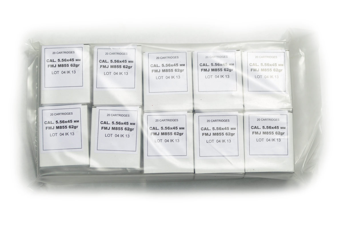

Privi packs there ammo in 200 round plastic bags I took those and then stored those bags in ammo cans. While the privi is not vac u sealed its the same concept. So why not vac u seal. Won't hurt.
9/23/2014 1:51:51 AM EDT
"Privi packs there ammo in 200 round plastic bags I took those and then stored those bags in ammo cans. While the privi is not vac u sealed its the same concept. So why not vac u seal. Won't hurt."
Because pulling a vacuum on a poly bag just causes the humidity to diffuse into the bag faster and doesn't get rid of it either = does hurt.
Using a barrier film bag means water doesn't get through any time soon.
Using a barrier bag and a dry gas purge means the dew point of the storage conditions also no longer matter.
The vacuum isn't what adds value here if water in the package is the OP's concern.
The bags you see in those photos just keep the ammo organized and clean, not dry.
Getting the dew point in the bag way down, and then making sure there is a hermetic seal on a barrier film bag is what makes the concept work, not the vacuum.
Vacuum is used on wet foods to reduce the amount of saturated air in the container, thus limiting the O2 available for oxidation.
If you really want to prevent ammo from getting wet in storage, you have to get rid of the water inside the packaging. A good N2 purge will do that but a crummy vacuum won't.
