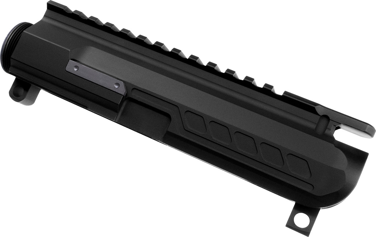

I got someone from Reddit to send me some pics.  I combined some for one picture with my comments:
4/24/2025 7:44:06 AM EDT
Just released: https://cmmg.com/fixed-ejector-retrofit-kit-9mm
You can see how the fixed ejector is secured to the upper (just like the Dissent).  Bolted from the inside of the upper.
