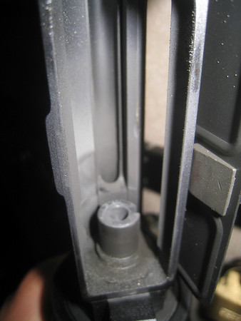

What is Spikes doing with their dedicated uppers that a regular .22 kit (Ceiner w/Black Dog mag) does not do?
8/14/2008 10:58:26 AM EDT
Umm, a dedicated barrel and a dedicated bolt assembly.
This means that your rounds are actually chambering IN the barrel (and not inside the front of the Ciener widget).  There is no chamber adapter, and there is no 2" jump to the rifling.  It also works.

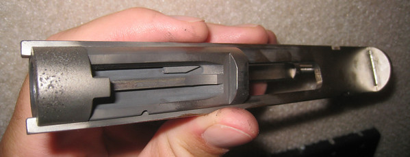

photosfromclarksylvania.smugmug.com/photos/344592396_fpDM8-M-1.jpg
photosfromclarksylvania.smugmug.com/photos/344593022_pGFtw-M-2.jpg
Interesting pics. I take it the breech extends right up to the feed lips on the mag with very little gap as there is no feed ramp of any kind? Is that a single recoil/guide rod and dirty great extractor bar? I take it the bolt group picture is reversed..
Nope.  The end of the assembly is a sleeve that fits around the chamber-end of the barrel, and has an integral feed ramp in it.
Nope.  The picture in the post above is taken from the left side.  The long bars you see are the action rails for the bolt (not a big extractor).
photosfromclarksylvania.smugmug.com/photos/344593298_N7DmX-M-2.jpg
Ah, I see it now thanks, that's an interesting way of doing it... Does that mean it's special upper to have the slots for the rails?
Not at all.  The only thing special about the upper is the barrel.  The Spike's Tactical bolt is an improved version of the 100% drop-in Ciener kit:
