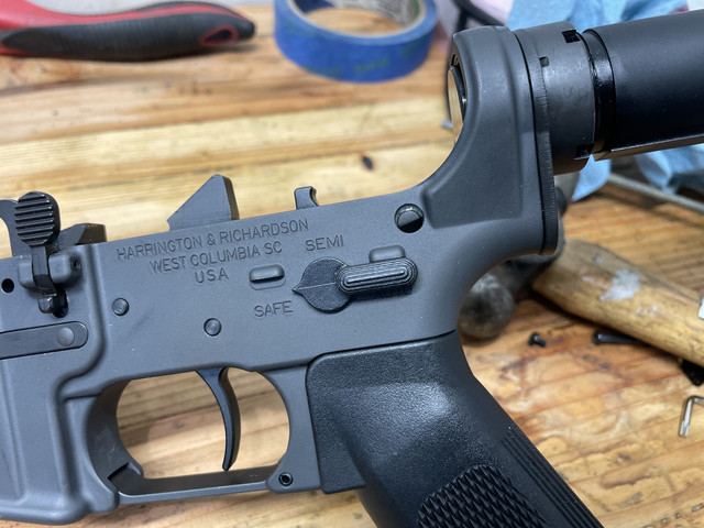

I previously mentioned that I REALLY wasn't a fan of the safety/selector that comes with the DTT/RBT FRTs.
I apologize; in hindsight that was a grotesque UNDERstatement.
After installing @ssgtcarroll custom machined MIL spec safety/selector, I'm confident in saying that the ones that come with the FRTs are complete dag shite, and the ones that @ssgtcarroll are making are THE standard; at least for me.
They're NOT ambi however, and I thought he mentioned he might be looking at doing that down the road but I don't wanna put words in his mouth.
In the picture below you can actually see space from the DTT/RBT safety/selector on an Aero Precision lower:
@ssgtcarroll's fit exactly as you would expect a MIL spec safety/selector to fit in a MIL spec receiver; perfectly!
Where the stock safety/selector felt janky/mushy and otherwise imprecise; this feels the polar opposite and what you would expect.
The stock piece was my biggest gripe with the FRT and for short money it's fixed.
While swapping the one out on my CMMG Banshee I noticed some a couple things that were NOT giving me a warm fuzzy.  This particular PCC had the highest round count out of all the FRT installs I've been testing, but wasn't higher than 300.
Both sides/selectors had worked loose from their Torx head retaining screw, which came pre-gooped with LocTite.  I had torqued them as far as I felt comfortable with when installing it previously, and this was NOT an issue on any of the other installs, just making note.
Another thing I noticed is that the detent itself was definitely showing signs of wear and you can see tiny metal shavings on the mat around the tip of the detent, which is showing silver from the damage while the rest of it is more brass colored. (sorry that the picture is slightly out of focus.)
I'd attribute this to the sloppiness in the stock safety/selector and additional, out of spec movement causing the galling of the detent.
That's a layman's opinion as I'm not a machinist or metallurgist and there's way more knowledgeable people here that might know what's up; just my observation.

Post match today I test fired 3 installs of @ssgtcarroll's machined MIL safety/selector.  While I previously dry fired it post installation and it acted exactly as the stock/ambi safety/selector did I wanted to get some live fire.  Another gentlemen with a Sig with a Parker Mountain Machine trip bar (5.56) was there and had the DTT/RBT stock safety/selector installed on his.
All 3 installs of @ssgtcarroll's safeties worked perfectly; CMMG Banshee .45 PCC/SBR, 300 Blackout suppressed/subsonic Aero Precision build and 5.56 SBR/OSS K-can Aero build as mentioned in OP.
Several people did finger bang both the stock and Mike's safety and the consensus was it was NO comparison; the stock has a janky, vague, sloppy and toy like feel while his is a legit MIL spec duty use piece.
I get how so people might be chapped about having to spend another $40+ on another safety and likewise for KNS Precision anti-rotation trigger/hammer pins when you're already $500 into the FRT itself but that's relatively short money to get it over the finish line and going from range toy to serious/duty use...

No failures, no light strikes.
When did you grab one of my selectors? The first batch did not have enough clearance. Does it act the same way with the original selector? If it’s better let me know. I’ll send you one of the newer ones.

I previously mentioned that in addition to the janky ass, sloppy AF plastic fantastic ambi safety that's included in the DTT/RBT FRT packaging I felt their trigger/hammer pins left a lot to be desired too, particularly the lateral/side to side play that seemed excessive.
The top set of pins in this picture came out of my Aero Precision .300 BO build, which currently has between 2-300 rounds through it, all subsonic/suppressed.  I thought this wear was...excessive.
The bottom set of pins is out of my CMMG Banshee (.45).  While it doesn't show any visible wear it's worth noting that despite the presence of Loc-Tite the screws were backing out of the pins.  That particular gun has a slightly higher round count of between 4-500, all 220/230 grain +P ammo, suppressed.
I've always been a fan of KNS Precisions anti-walk/rotation pins since they saved me from trashing an otherwise solid lower years ago that had egged out holes with their slightly larger than spec pin kit.
Sooooo...I've added those to my FRT builds in addition to "red"/extra power carbine length Sprinco buffer springs on my 5.56 and .300 Blackout.  The one is my 5.56 build was within spec but rather short at 10.5-inches so I figured it was good insurance.
