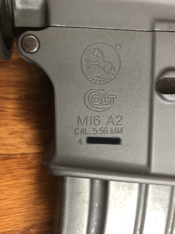

Ah, I see. So an M16A2 marked lower, with a Burst marking, would not be appropriate?
The Delta rifles were Commercial Off The Shelf (COTS) guns.
They were not Government Property marked guns so they did not conform to a US Military Standard.
There was a difference between what the US Military called an A2 and what Colt called an A2, and the Delta guns used in Somalia were What Colt Called an A2 with a COTS M16 A2 rollmark and full auto fire control group.
The first Colt A2s had 1/7 twist barrels and that is the biggest differentiator between Colt A2s and Colt A1s.

Are there any known images of the receiver markings on those guns?
1/27/2026 12:40:54 AM EDT
Yes, they looked like this.
Ah, I see now. I wasn't understanding the difference between the model number of M16A2, and being marked US Property (or some version of that).
Thank you!
1/28/2026 5:27:11 PM EDT
No worries, it causes a lot of confusion.
