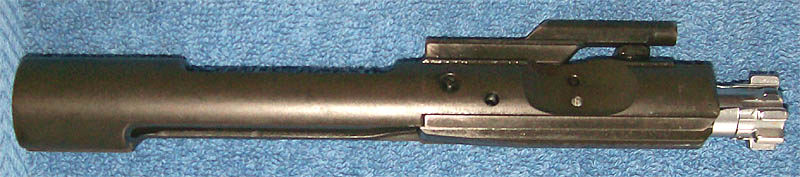

Big brown truck dropped off a box today containing a bunch of new-to-me retro parts.  The collection appears to be much of what was once an early (I place it at 1965) SP1.
I have to say, these parts are gorgeous––as close to "new" as I've seen.  But we've all see plenty of old barrels, Edgewater buffers, early buffer tubes, square pad dust covers, etc.
This "Transitional" bolt carrier group, however, I thought is worth sharing.  They are referred to here from time to time, but we don't seem to see too many––at least not that we can be sure are the way they left the factory.
Admittedly, I can't document this one to the factory build, either, but based on the rest of the parts that came around it, and comparing it to notes in the SP1 guide, I do believe that this one is 1965-fresh.
Some of the interesting characteristics:
––Parked carrier with automatic sear trip cut back
––Full round carrier key with two round stake marks on the inside edges of the screws
––Chromed bolt with thin band and electro-pencil marked "M P"
––Machined retaining pin, parked (unlike the chrome ones in 601s)
––Second gen "flat head" firing pin
Good pic here showing the carrier cut-back.  Bottom carrier is full-auto from an XM16E1.  Middle carrier is this early SP1.  Top carrier is a modern semi-auto.
So...now I need to find a '65 SP1 lower in pristine condition.

Gunner,my in box 64 SP1 has the middle carrier. Both HK45shooter and Kurtvf have either 65 or 66 dated SP1s and I think both of them have the middle carrier as well. May want to shoot off a couple of emails to them to verify. My 64 is on top in my pic

Collectively, nice find.  Individually, I think the most interesting and probably hardest to find part, even by itself is the parked, machined retaining pin.

all 5 of my early SP1s sport that carrier.
the 3 digit and 2 early 4 digits (up to 3xxx) all have the chrome bolt
the 2 late 4 digits (7xxx and 9xxx) have the parked bolt
