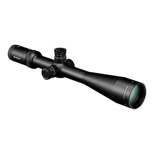

The rule (my rule) is...
16" barrel - Vortex HS-T MRAD 4-16x44mm - around $550
18" or longer barrel - Vortex HS-T MRAD 6-24x50mm - around $600
The logic being, if you are building a 16" .308 then you are going for something compact and light weight and the 4-16x44mm is a little lighter than the 6-24x50mm
If you are going with an 18" or longer barrel then weight is not so much of an issue so go with the bigger scope for longer range.
Here's what the Vortex HS-T 6-24x50mm looks like

yea my AR is already setup with a 24" lilja barrel so weight or size is really not a concern of mine. It just confuses me on how guys like shooting long distance with such low magnification I didn't know if there was some hidden benefit to it besides a smaller scope size/weight which I don't care about. I would much rather be able to zoom more to the target if thats just the flat out only difference in performance between the two.

and I am a little discerned by the less travel adjustment for the higher powered 6-24 vs the 4-16 I just want to make just Ill have enough adjustment on the scope to shoot whatever distance that may come up. I have heard needing a lot of adjustment for the .308 round  i just ordered a bulk pack of 168g winchester rounds which seemed like good target practice loads

Heat mirage can be a problem with long distance shooting and high zoom. You can't always utilize past 10x to 15x zoom depending on conditions. I'd personally would rather have more zoom and not need it than not enough zoom.
