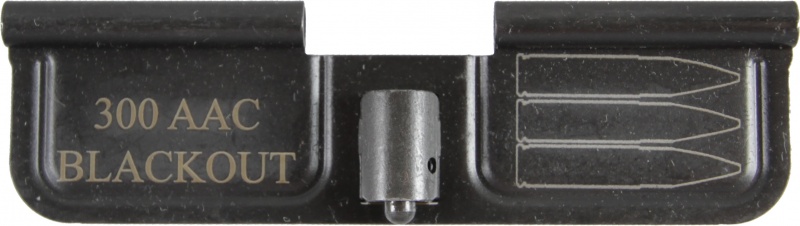

^^^ 5.56 won't chamber in a 300BLK... the reverse is a bigger issue / risk.  The gas is dependent on the barrel you buy (port location and size) and assuming a reputable manufacturer will likely be fine as is.
I would argue that you should be checking upper / barrel markings for caliber confirmation if confused (never the lower on an AR)... add a port door marked on both sides:

Oh yeah, well I wouldn't put a 5.56 brake on the barrel. I'd just put a 308 on there.
The laser engraved dust cover is a good idea. I will go that route and then I can just build a 2nd upper for 5.56 and use the same lower.
A dust cover would be an inexpensive way to mark the rifle.

Like they said before a .223 won't chamber in a 300BLK. It is nearly imposible for that to happen but even if you took a hammer to it and forced it in the only thing that would happen is you are now shooting a .223 out of a .308 barrel. As for the flash hider you can't put a .223 one on the 300BLK as the threads are not 1/2x28. I do have dust covers on some of my AR that say 300BLK just so people know what that ultra quiet gun down at the end of the shooting range is.
