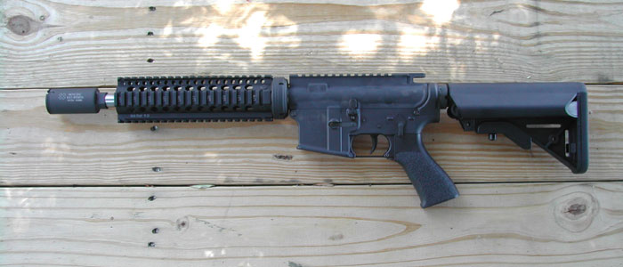

For reference, here is a 9" Daniel Defense on a 10.5" 6.8 SPC barrel I test fired last weekend.
Muzzle has a KX3 on it.
