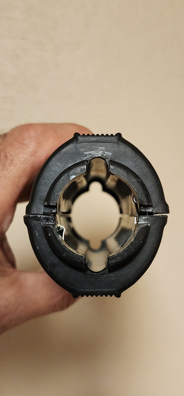

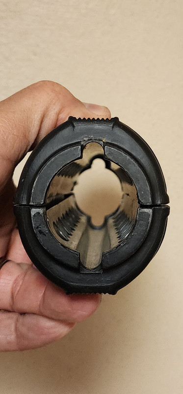

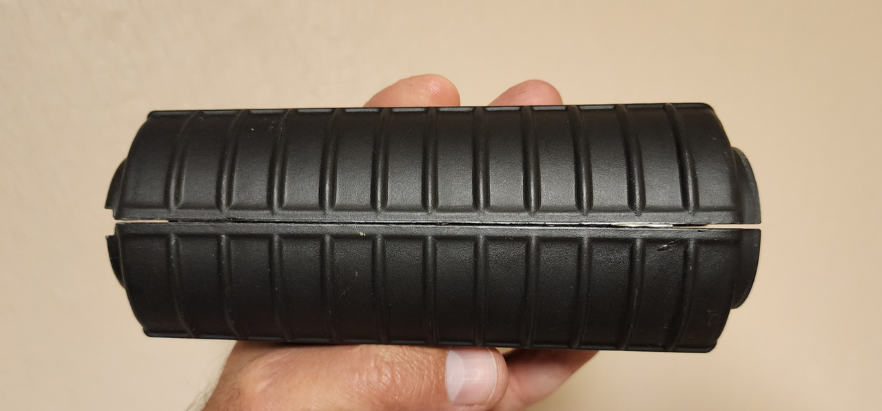

Yesterday 8:34:55 PM EDT
Colt M4 oval handguards:
