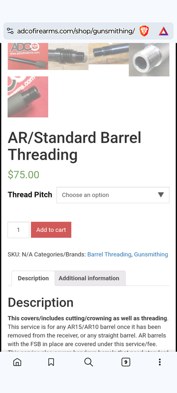

You can get a new barrel for $75?
That's what ADCO charges to cut and thread. Not trying to plug them, but they do great work and fast turnaround.

Today 10:16:51 AM EDT
https://i.postimg.cc/qBYRnwbd/Screenshot-20260921-090019.png
Add shipping as well
