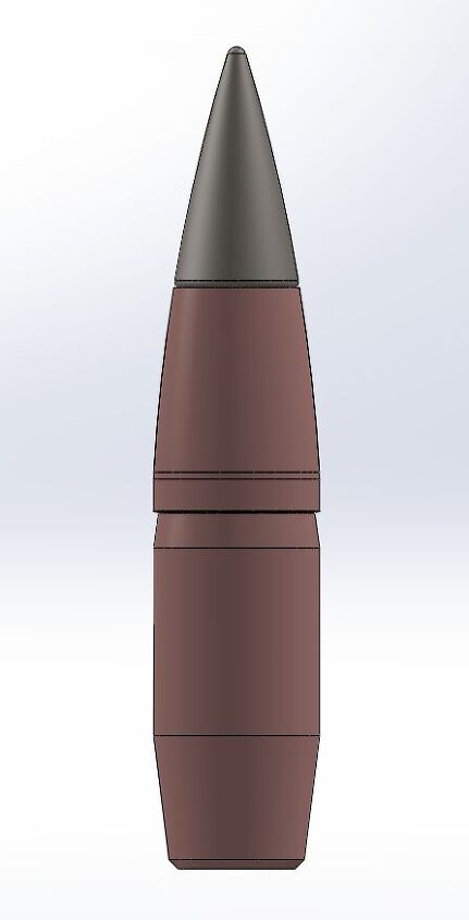

The 97gr Tungsten offering is fascinating - zooming in we see it's a "Tandem Warhead" design, with a front penetrator designed to shatter the ceramic, with a pointed 2nd penetrator designed to then punch through that ceramic fracture.
