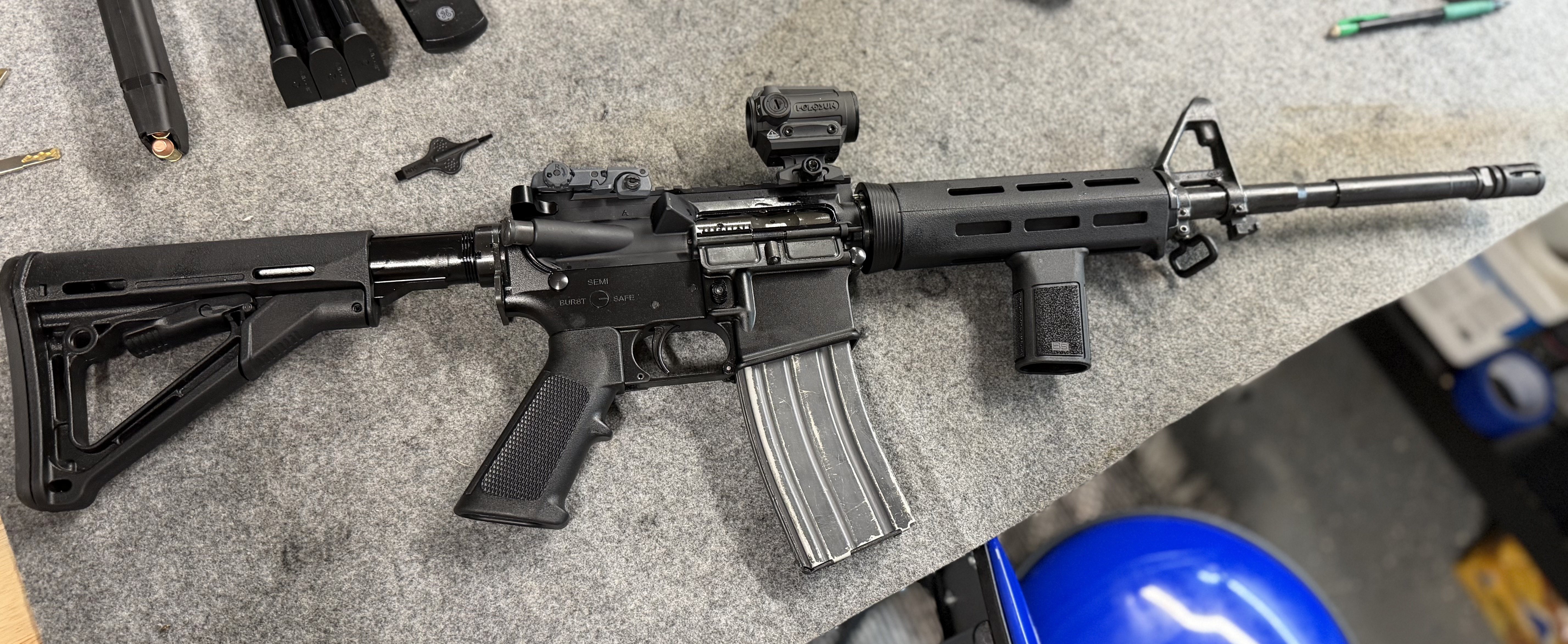

![]() Tossed one in this BKF chrome lined patrol upper. Only $250 with furniture. Nice little budget blaster, the Holosun ARO is nice. https://bkingsfirearms.com/shop/complete-upper-receivers/bkf-ar15-16-5-56-nato-1-7-twist-m4-patrol-series-complete-upper-receiver/ |
Originally Posted By AS556: https://i.ibb.co/69J0237/IMG-9035.jpg Tossed one in this BKF chrome lined patrol upper. Only $250 with furniture. Nice little budget blaster, the Holosun ARO is nice. https://bkingsfirearms.com/shop/complete-upper-receivers/bkf-ar15-16-5-56-nato-1-7-twist-m4-patrol-series-complete-upper-receiver/ I am digging that build. Any idea who BKF uses for their barrels? |
