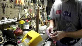

The purpose of lapping is to produce a smooth surface. The bores of firearms need to be very smooth for several reasons, and so they are lapped. There are several methods. I always find seeing it done more helpful than reading about it. I write far better than I read.
![]() Lapping part 1 And part II: ![]() Lapping part 2 Lapping is a very simple process, but it takes skill and patience to do it correctly. |
               ![]() LAPPING A BARREL |
