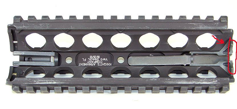

I installed a RAS on a buddy's rifle, and we had to use a dremel to remove a small amount of material from the front mounting mechanism (grey piece) on the KAC RAS. Since install, he's had zero issue with the modified setup.
Here's a photo showing the area we had to use the dremel on.

The RRA barrels are too thick for the RAS. They are heavier profile than the SOCOM. At least, that's how our Entry Tactical and Elite CARs were.
<a href="http://s199.photobucket.com/user/muad_dib1982/media/KAC-RAS-RRA_zps0bafb4ba.jpg.html" target="_blank">http://i199.photobucket.com/albums/aa46/muad_dib1982/KAC-RAS-RRA_zps0bafb4ba.jpg</a>
ETA: spelling and such
I figured it had to be a flange on one or the other that wasn't clearing.
