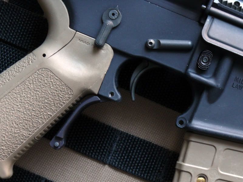

My Magpul trigger guard folding version, I also have the non folding model on my other carbine.
I wanted to use the wood block method but can't find any in the house so I just use my FSB cradle which already have holes for the pins to go thru.
I used my pin punch and 8 oz brass hammer and removed the original pin a little at a time with light hammer strikes, just be patient and don't use excessive force.
To install the new roll pin I used the vise grip method (link below) then finished up again with the punch, hammer and support.
