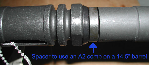

7/29/2006 8:45:24 PM EDT
Not the standard A2 unless you shim the hell out of it, providing you have enough thread.
Thread length is 5/8" on a typical AR type barrel.
You need to add about 1/8" or so to get most 14.5" barrels past 16" with an A2 comp.
Here is a little spacer I have made to solve the problem:
Spacing a standard A2 forward is not an issue, but it's not as nice looking as a Phantom or Vortex which have much more CDI factor.

7/30/2006 12:01:06 PM EDT
Yes, if you have a 1.5" PERMANANTLY attached flash hider on a 14.5" barrell, it counts as a 16" barrell.
There's MORE too it than that
The muzzle has threads right?
Those threads are 5/8" long.
You would have to thread that 1.5" long muzzle device on to those threads before you could permanent attach it right?
As the muzzle device now overlaps the barrel, you LOSE that 5/8" effective length.
A2 comps are like 1.75" long
Then you add a crush washer for about 0.125".
This gets you to an effective addition of 1.25" to that 14.5" barrel.
You may be quick with math and note that you are at 15.75" long now.
You may NOT know that most 16" and shorter barrels are made about 1/8" longer than specified, so that 14.5" barrel is probably a 14.625" barrel.
Now you may note that you would only be 0.125" short of legal.
Then you may even ask about 14.7" barrels and think "gee, that would work" and you would be correct.
Something else, those 14.7" barrels are often more like 14.8" for safety margin.
Long before 14.7" barrels were common, I was shortening 16" barrels down to 14.8" to permanent attach an A2 comp.
One more thing, Phantoms and Vortexes are 2" long and WILL get you past 16" on a 14.5" barrel, but you probably knew that...
