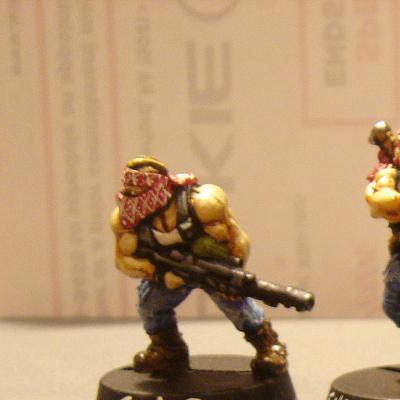

Games Workshop makes paints for miniatures that are pretty solid. But wherever you can get away with using spraypaint, you probably want to use that. If you're priming in a camo color, Krylon Fusion Camo actually works very well for miniatures as long as you spray carefully and give it a day to cure up properly.
Flat brushes are great for everything but detail.
This is a crappy picture, but I did this 28mm model with GW paints. The bandana is "green stuff" (2-part modeling putty). It's for a wargame. The brushes and paints I bought when I was 10 years old or so, so they've been sitting around for a decade and a half before being used on this guy. The stuff lasts.
