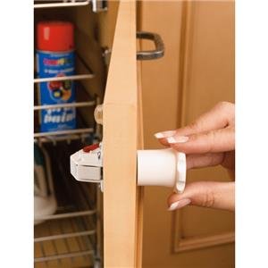

10/20/2015 6:36:51 PM EDT
magnets
how do those work?
10/20/2015 6:43:13 PM EDT
Tot lok
