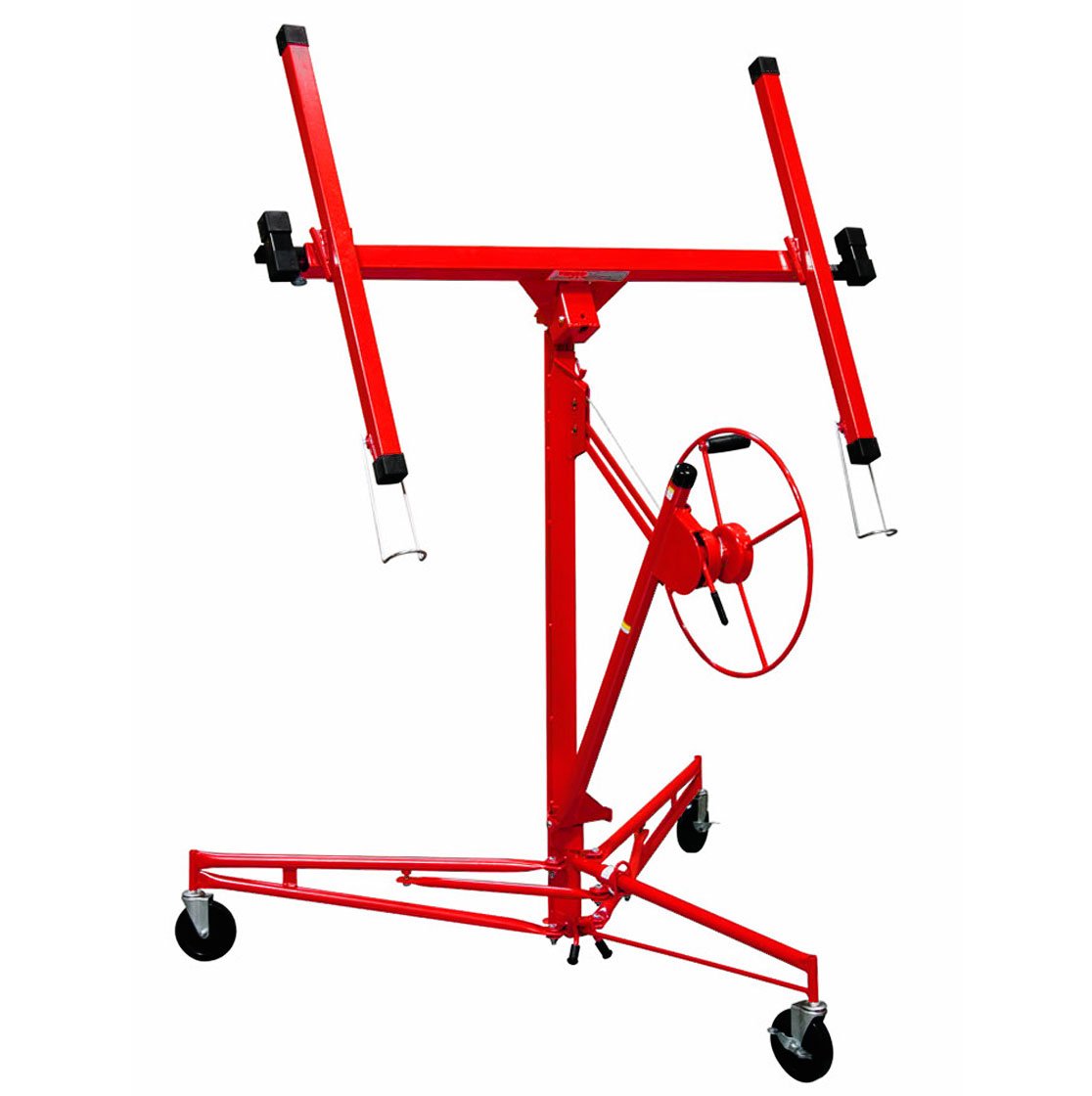

If I mathed correctly that's about 60 boards.  I am paying hangers $10 a board to hang and $10 to finish (except for level IV and up smooth).  I'd probably pay $12 a board for the 12' ceiling height.
You can rent/buy a drywall lift:

Rent (or buy) a ceiling sheet rock hanging tool but confirm it can reach 12'.
Ceilings are easier to hang than walls with this tool.  Actually the only hard part is lifting a large sheet onto the machine.  I've found 5/8" thick 4'x10' panels quite difficult to move alone.  You will probably want 5/8" thick for ceiling fire rating.
http://ecx.images-amazon.com/images/I/61QR4-Yh3qL._SL1120_.jpg
That or at the very least make up a T with 2x4s

dw lift                                                                                   $150 to $250

If you didn't want to get a lift you could build a small scaffold for two guys, but getting the dw up the scaffold is a bear.
