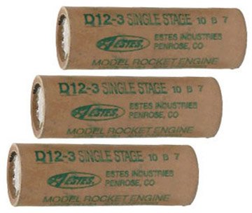

Most everybody got the important tips/tricks.
Now...if you want to go fast.
