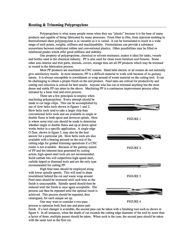

My 1st phone call was to customer service at which time they told me that they don't recommend any cutting or drilling and that I'll void my warranty. My 2nd phone call I was talking to someone in a division that does panel mounting options of these cases. He basically said to go slower than faster, use the correct bit, and good luck. He mentioned to treat PP Polypropylene like other plastics in the sense that it has properties similar to ABS and Acrylic and that there was nothing special they added to their plastic molding process. Just a thick pour of polypropylene. |
What is the correct RPM and correct bit to cut clean without melting ? The best bit to use for holes is a flat type wood bit. Bit speed should be kept low and use a reasonable amount of pressure. Last sawing I did on plastic, and it's been a while, I used a coping saw. Make a good cut, but then work slowly, and definitely avoid sawing back and forth using a small part of the blade - use the whole blade and keep temps down to avoid melting the plastic. Coping saw probably isn't much help if you need high accuracy though. Maybe cut out to a smaller size then use a good sharp file to smooth it out and get to final dimension. |
