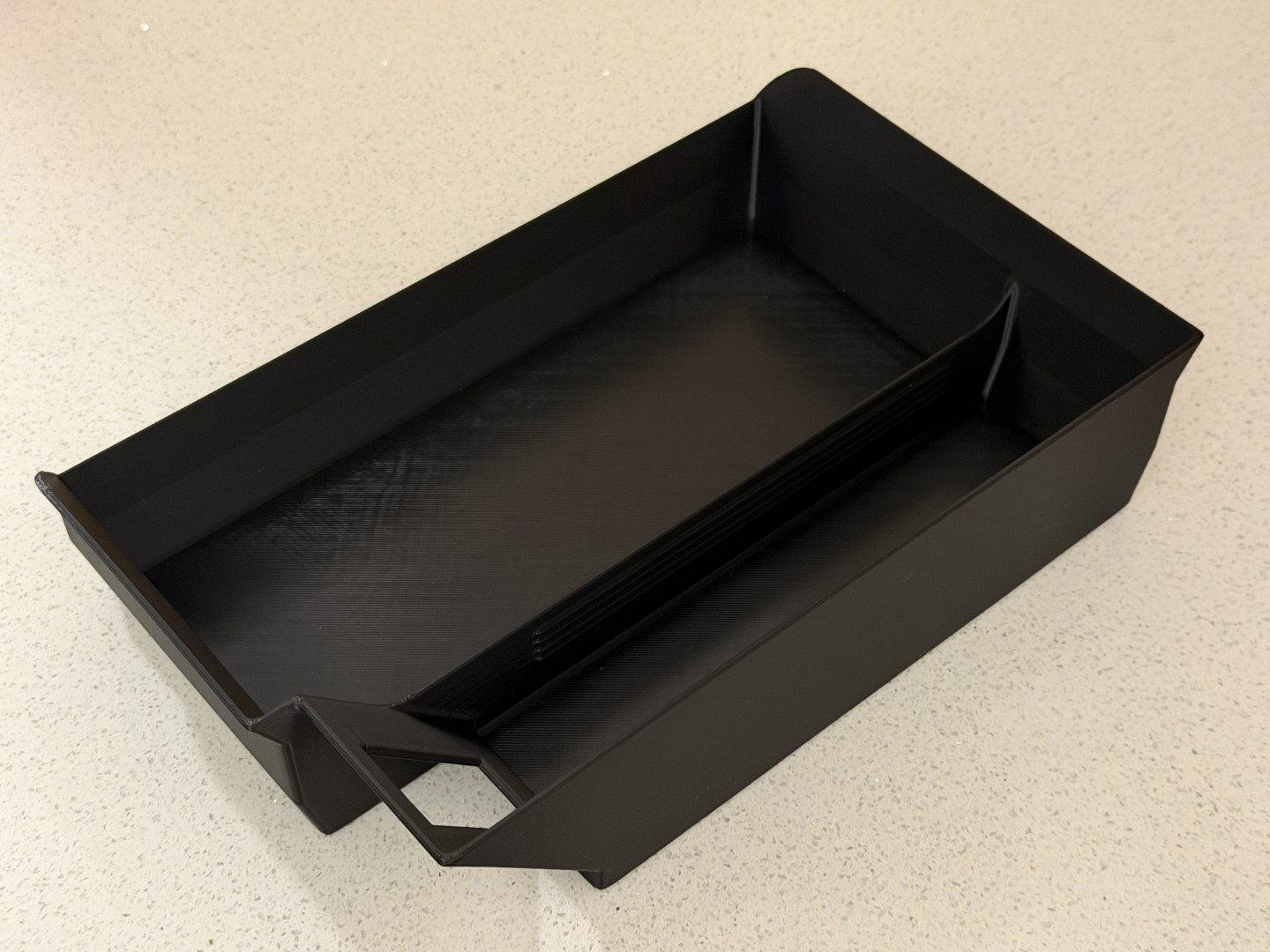

Even after drying for over 24 hours, AMS holding at 2% humidity, and printing with 110* bed temp and an 8mm brim I’m still getting lifting on the corners with my ASA. Any ideas?Attached File
5/14/2026 1:25:17 PM EDT
Originally Posted By plinker8:
Even after drying for over 24 hours, AMS holding at 2% humidity, and printing with 110* bed temp and an 8mm brim I’m still getting lifting on the corners with my ASA. Any ideas?https://www.ar15.com/media/mediaFiles/434409/image_jpg-3762248.JPG
It's not a moisture issue. Large squarish parts like that are very difficult without high chamber temps. If you can't get it up to 60C you could try printing it with ASA-CF. Alternatively you can add a generous corner radius if your design allows which should help.
5/14/2026 1:55:29 PM EDT
You need a chamber heater for large parts like that.For medium sized parts, 60C minimum. For large parts, 65C is better. I've printed perfectly square parts 280mm long with zero warping out of both Asa and ABS but had chamber at 65C.
You could look at Panda Breath. It's not perfectly integrated but it's the best solution for Bambu printers without a build in chamber.
5/14/2026 2:16:24 PM EDT
[Last Edit: turtle2472][Edited] [#4]
I managed to print this console organizer for my van with ABS in my P2S with no warping or corner pulling.  I forgot what the bed was, but pretty sure it was 100°C.  I also turned off the right fan.  Chamber got into the upper 50's by the time the print was done.  I might have also preheated the bed to help with this before sending the print job.

5/14/2026 3:52:19 PM EDT
I see, thank you guys. I was thinking that 50+ chamber temps would be enough after pre heating for half an hour. Oh well. This part does have a 10mm radius on the corners inside for added strength but even that’s not enough I’m seeing. Off to do some shopping
