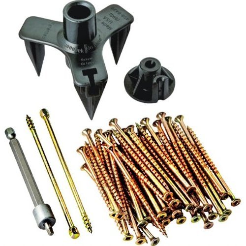

Anyone try one of these kits?
Amazon Product
  • Eliminates squeaks between floor boards and joists
  • Engineered plastic alignment depth tool
  • Can be used on carpeted floors
www.amazon.com/dp/B0006IK8YE
Never have but I watched an episode of This Old House and Tom did a demo.  Looked like a good solution for a carpeted floor.  The cost is a little painful but cheaper than a new carpet.
