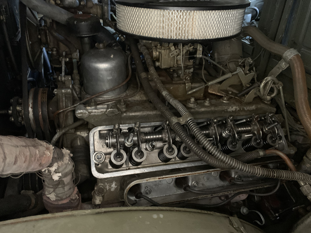

11/22/2020 2:25:32 AM EDT
Not a good day for the brdm.
Broke down..but we determined it was out of fuel on one tank. Easy to fix.
The engine was on the top end of the temp gage because I wasn’t thinking. Determined it died because was because the one tank was empty. Switched it to the other one and after @m35ben primed it it fired up. I totally didn’t flip the louvers up before driving.
There was a fire on the back right of the engine. Small fire, just a single flame. Like the size of a clenched fist. The valve cover gasket is leaking oil. I guess it hit the headers and caught fire.
I’m beyond pissed and disappointed.
So far:
Hydro leak located on the radiator
Brake is still Stuck-unit will likely need completely overhauled because it was, last I checked, SMOKING.
shudder when braking
Brakes 50-50 purged
Valve cover gasket leak
Time to call Oleg for some parts ASAP.

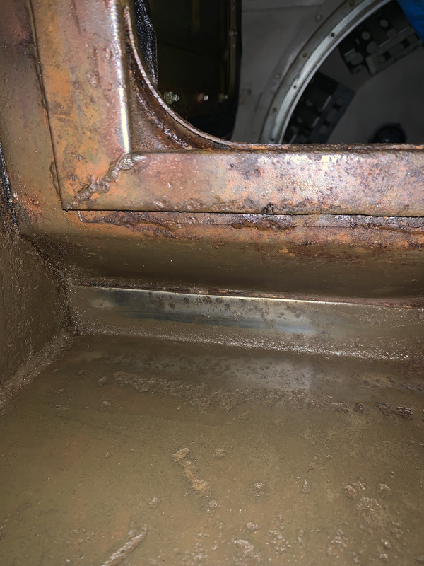

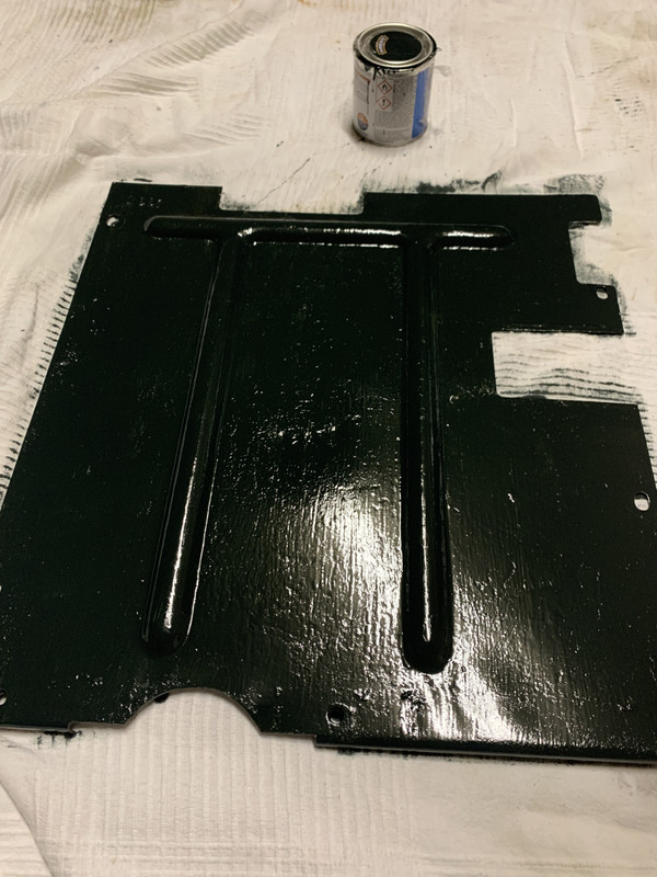

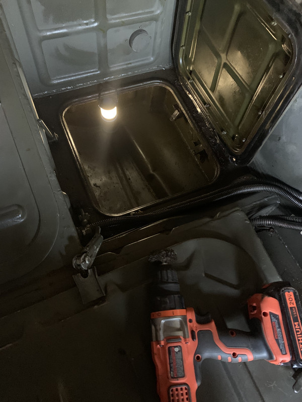

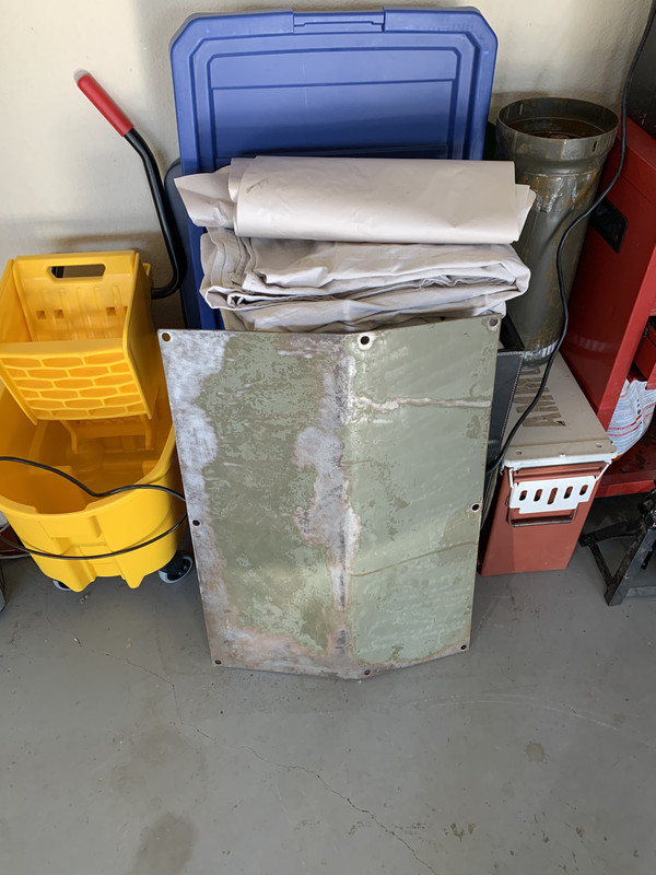

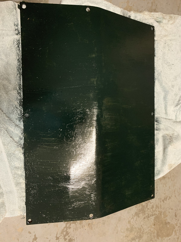

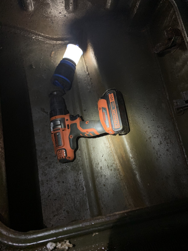

Spent about an hour scrubbing tne rear storage compartment.
It had filled with water and mud and rusted at one point.
Unacceptable
So I charged up the cordless drill and had it. After 45 minutes of wire brushing it looks ten times better. Not perfect, but better.

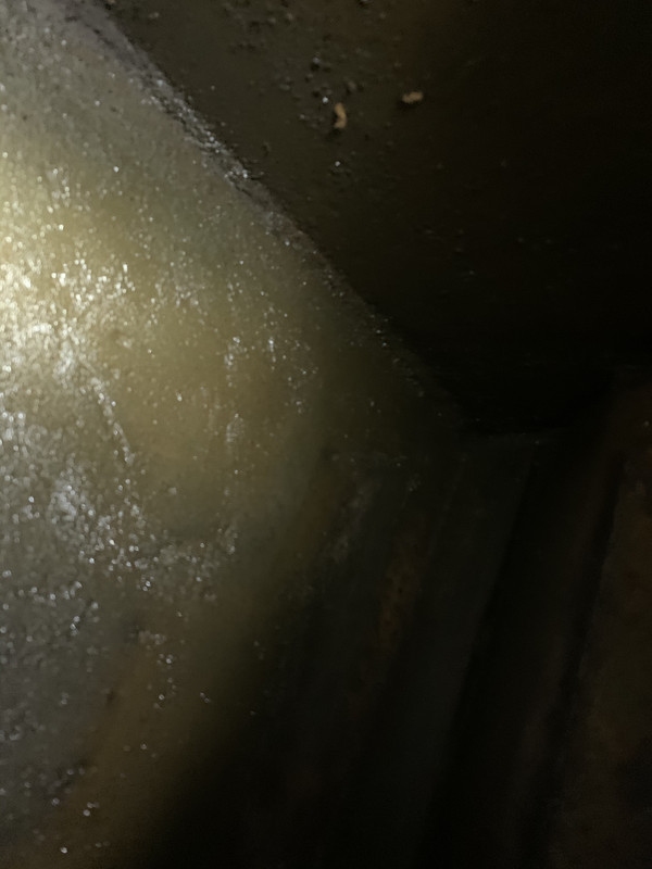

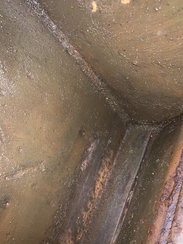

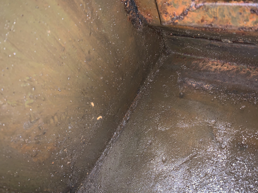

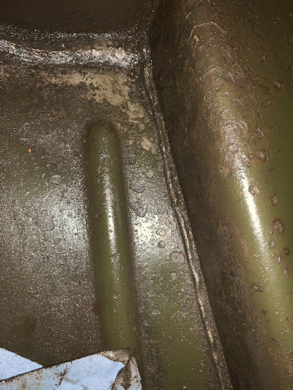

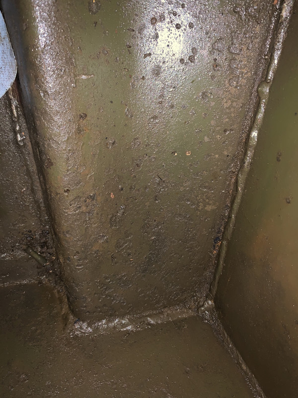

12/8/2020 10:19:27 AM EDT
Any of this rust or pitting look worrisome?
Blyat
12/12/2020 1:19:59 AM EDT
[Last Edit: 545days][Edited] [#17]
Not to me, but I am restoring a 40 year old FIAT.  I would be thrilled if it looked that good.

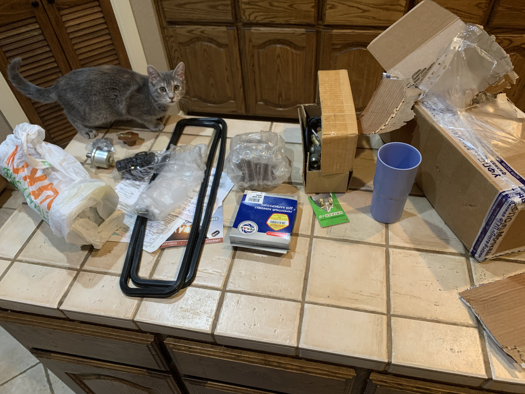

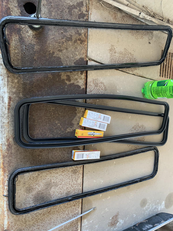

I sent 500$ to a random russian guy and he appears to have kept his word. Or he didn't and sent me a bag of rocks, but whatever he sent me just hit New York city.
4x Drum gaskets
1x Carb rebuild kit
4x Brake rebuild kits
1x Drum (Like the entire heavy thick metal part).
Oil pressure sending unit
DIstributor
ROtor
Cap
Random other brake parts
Pretty sure there's a couple more I'm forgetting, but it's just what we need to get the big chunk of iron back on the road.
Just kidding, I have been buying stuff from Oleg for years now and he's reliable as rain.
Blyat

My wife texted me And let me know some large packages from Russia arrived today.
Oh boy oh boy oh boy oh boy.
I’m stuck at work.
Blyat
1/2/2021 8:20:49 PM EDT
Lot of parts here, one more package coming. Kitten for scale.

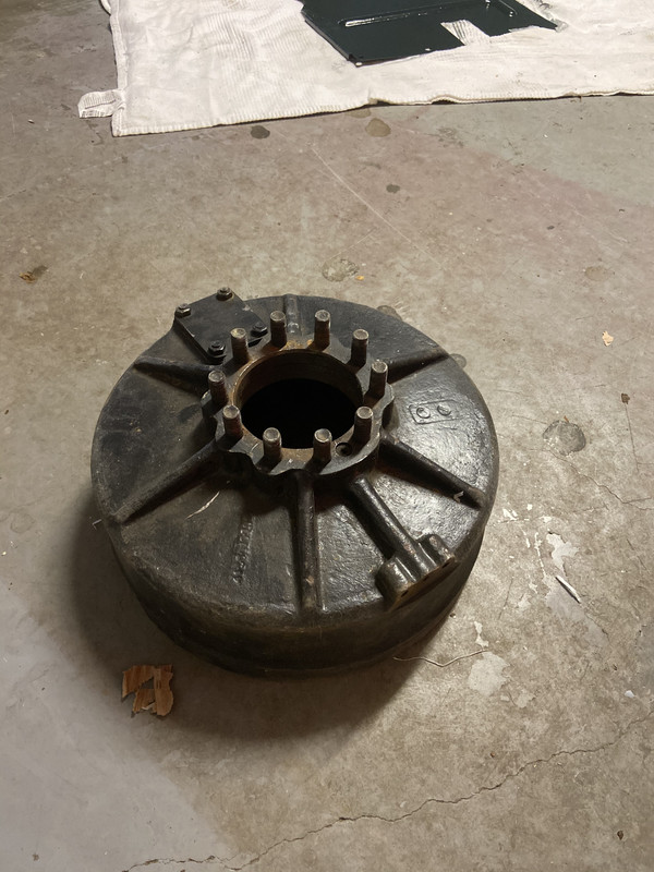

2/6/2021 8:53:12 PM EDT
Pulled the brake drum off today and found fluid on the shoes.
nothing of value here

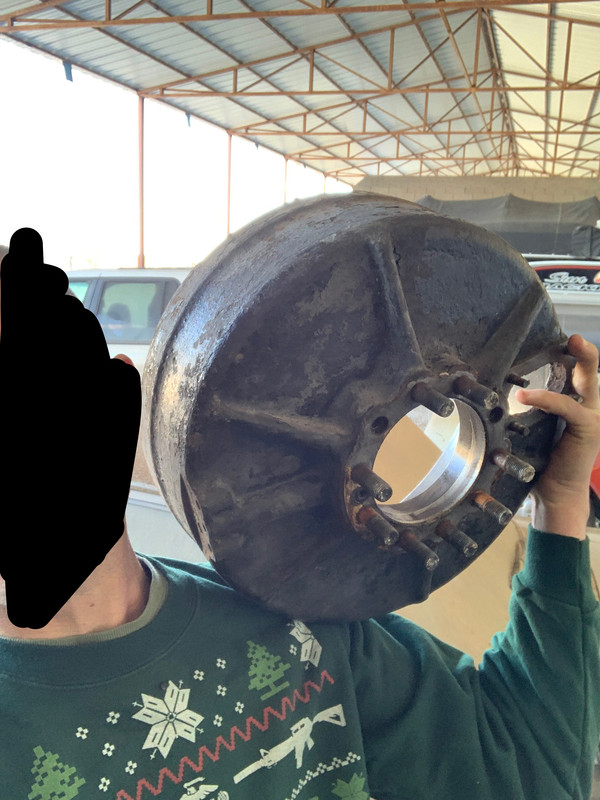

2/6/2021 11:43:24 PM EDT
These drums are thiiiiick
Blyat

New parts list for oleg:
3x sets of brakes
1x drum
2x fuel tank sender units
3x sets of brakes
1x drum
1x fuel tank gauge
Look on the bright side. At least it's at your house.

Wire wheeled some rust and corrosion off the rear jet cover and painted it with hammerite. Unfortunately it was waaaay darker than I expected.
Before
(After wire wheeling off the rust and scrapes)
It has the same consistently and texture as the pain on the upper interior hull.

Brake drum arrived. Post office guy was a total wuss and my wife hefted it to her car.
(I was at work and she picked it up for me).
Now I have a spare.
