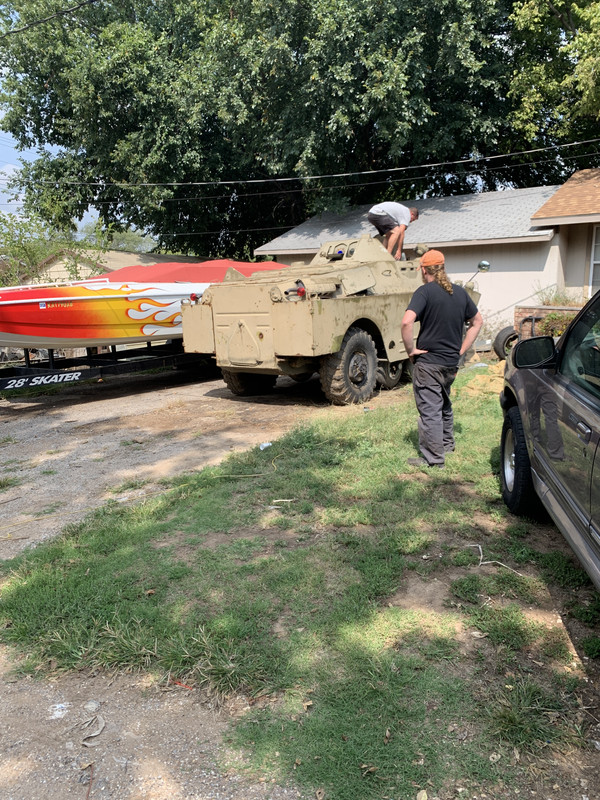

9/1/2020 2:35:49 PM EDT
[Last Edit: mancat][Edited] [#9]
Wait does yours have the turbodiesel? I was reading some Czech variants have that instead of the GAZ gasser
What's the deal with the brackets at the rear? I can't find any info about what those are. Almost look like recovery gear or some sort of carrier for equipment
9/1/2020 2:45:27 PM EDT
On the “rkh” configurations, those things are hand-loaded before a mission, with contaminated area warning flags so that personnel don’t have to expose themselves to emplace the flags once in a contaminated area. The flags are held in those racks and then “shot” into the ground by a downward blast via a control inside the vehicle. The BRDM2 had several iterations of on-board chemical agent detection and identification systems throughout its service life.

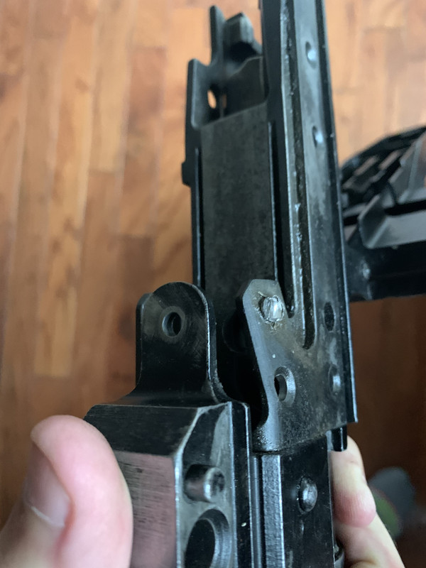

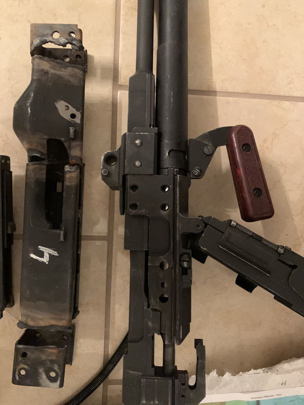

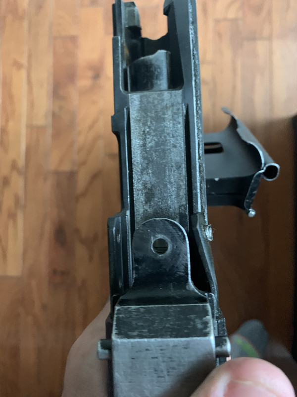

Good and bad news today.
The pkt kit arrived. Unfortunately a good chunk of it is unuseable due to damage to the front trunion, In addition to being well used (supposed to be a pristine kit).
The front right leg (looking from the back) is bent.
Well, piss. I’ll see what bowman says about a return.

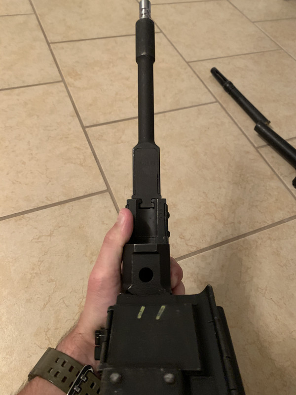

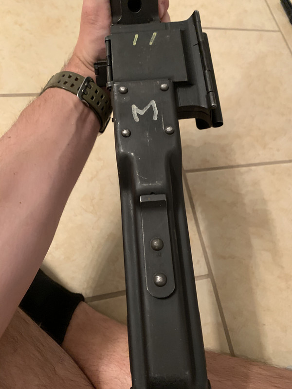

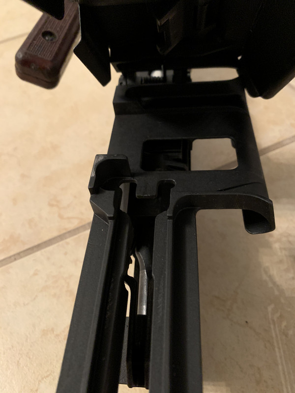

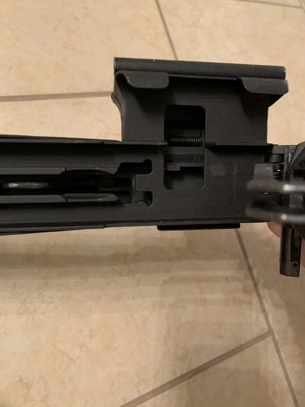

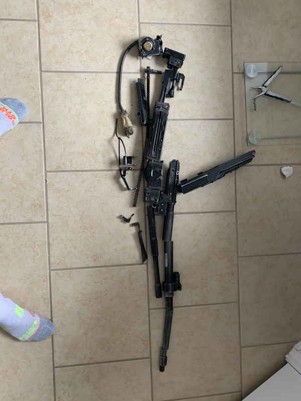

Replacement PKT kit arrived today.
Perfect shape 1978 7.62x54r pkt.
I’m stoked
Blyat
9/19/2020 10:55:56 PM EDT
Even better than I expected. I was finally able to dig into it a bit and it’s more or less a new gun that was cut up. A shame.
It’ll be a nice semi build

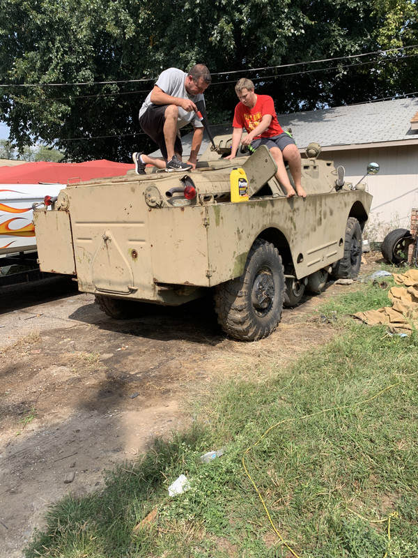

9/21/2020 3:46:59 PM EDT

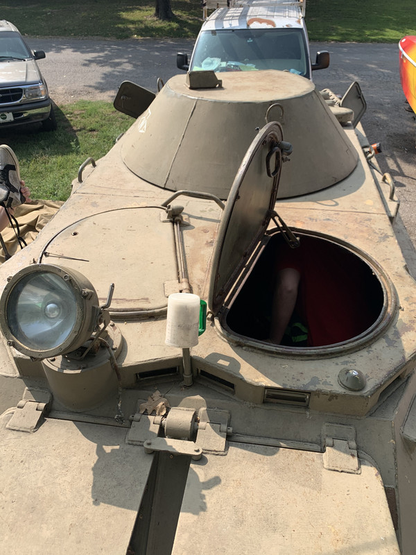

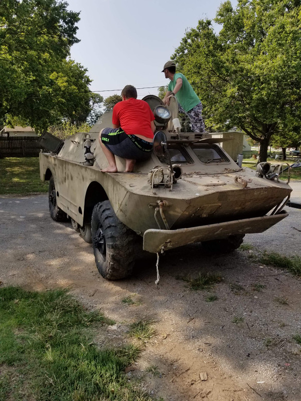

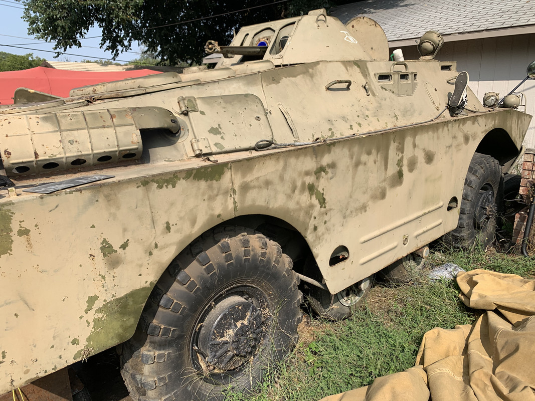

Very bad shape.
Engine is screwed up.
Massive blowback from the crank case
Huge plume of steam
No coolant and yellow dye all over the inside
Sticky brakes
Asking a huge amount of money, 50g.
So sad seeing it degrade to this. It’s worse than when I sold it.
Little side note on the pathway to get mine street legal.

Ugh.  This is the first one you ended up with then?

Happy update to the previous rabbit trail. It’s coming home.
Blyat
9/26/2020 12:11:02 AM EDT
Originally Posted By fadedsun:
https://i.postimg.cc/nztZ0Gqd/D75-A29-DC-7-D74-4309-A27-C-549-DADFA7-C8-F.jpg
Dafuhk, you got your original back?
9/26/2020 12:35:46 AM EDT
Loooong story
I bought this vehicle sight unseen In the summer of 2012. It arrived from England and went to Indiana then to me. I  Worked on it off and on for 4 years then sold it and used the money to buy my current one which is...immaculate. Next to unmolested.
About 2 weeks ago a guy messaged me and started asking questions. He wanted a brdm. I asked the guy I sold my old one to if he was interested in selling it and he said yes.
This is the saga of the traveling BRDM. From russia to Iraq to Kuwait to England, Indiana, Texas, Massachusetts, Kansas, and now back to Texas.

This one is going to a guy in Dallas. He is a mechanic and will restore it to 100% operating condition INCLUDING making the kpvt and pkt functional.

I’ll do my best to assist.
Here is a photo of the Vermont one from a few years ago, slumbering next to an early M551. I do have more. It’s in very sad shape. The launcher is completely removed and the cover for it was left off for years, allowing rust to creep in. It does have the sight intact although you can’t tell from this photo. The story I was told was that it was a Desert Storm capture that was donated by the Guard. The museum is a nonprofit entity as far as I know.
The one in MA, well I’m not completely certain of the owner’s name; it’s one of a handful of people and I’ll have to ask around. The outside of it looked phenomenal with the original green paint and white numbers, however the interior had been (carefully) gutted. It being an rkh and myself being somewhat of a SMA on the identification of these vehicles, the owner had invited me over to explain the warning flag system, however it was missing all internal controls.
Edit to add:
Same BRDM2 can be seen on the far left of this photo, from a gentleman named William Maloney’s site. Side note: the MT-LB is operational and has undergone an exterior restoration since these photos were taken:
