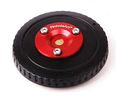

Or you could buy one already made...
But that takes all the fun out of it!
