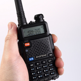

Bought a pair of UV5Rs. Range and performance were terrible. Read some advice and purchased the Nagoya 16" antennas. The radios are crisp and sparkling clear now under simplex testing.
Unfortunately the 16" antennas make the radio inconvenient to handle. Any recommendations for antennas that perform well with a smaller profile?

The stock 5R antenna is terrible on VHF, passable on UHF.
Best value for an antenna upgrade for the UV-5R is to just buy the Baofeng replacement antenna for the B5, last I looked they were like 4 or 5 dollars shipped on ebay.
People have comparison tested them against the Nagoya of the same size and they're identical.

I agree,  I have both the 16' 771 and the shorter 701 Nagoya antennas and they perform almost the same. The longer one obviously allows you to get the antenna higher up which is key.  I kept both,  I use the shorter one when im mobile and when im stationary ill use the longer Nagoya or even my slim jim rollup

The antenna you seek is the A-V 85 antenna.  It's what comes on many newer Baofengs such as the HPmodels and Igot a BF-F8+ (not HP)that had one as well.  They perform as well as the NA-701 antennas and it's what I mostly use now on my HTs.  It's not as floppy as the 701 which is a plus as well.  They're cheaper as well.

When I had my UV-5X3 (before it stopped working) the Nagoya NA-320A and V-85 antennas were indistinguishable in real world performance.  I was wondering why I spent the money on the Nagoya.  By switching antennas in mid conversation from various locations I quickly found there was BARELY any difference and to see that difference I had to be in an extreme fringe area anyway.

A while back I did actual driving down the road tests of the stock OEM UV-5R antenna (which I understand has been much improved now), the Nagoya NA-701, the Puxing J0125A $3.79 antenna (and various other prices under $5 USD), and the NA-771.
The OP is wanting something better than stock, and I have not tested the current UV-5R antenna, so will skip talking about something I have no experience with.
The Puxing J0125A $3.79 (etc) antenna is well made, and about 8" long, a handy length.  Driving down the highway talking through the repeater to the repeater owner, I got almost twice the range with the Puxing antenna, which I seem to remember being about 7 or 8 miles.  It was not only a great balance between length (about 4" for stock antenna, 8" Puxing) and performance, but price, too.  Very flexible, too.  At that price it was definitely the "best buy".
https://hamgear.wordpress.com/2012/07/10/the-3-79-antenna-review/
http://www.ebay.com/itm/201057408083
The Nagoya NA-701 gave 1-2 miles more range, but a little more costly.  It is also about 8" long, flexible, well made, handy size yet good range.
http://www.ebay.com/itm/281348801197
The Nagoya NA-771 gives the greatest range, by another 3 miles or so over the 701.  It is usually about the same price as the NA-701, but the drawback is that it is about 16" long.  Hang it on your belt and it'll put your eye out.  Sorry, your handi-talkie is no longer handy.  My opinion.  It does give the best range, however.
http://www.ebay.com/itm/121601486079
For the price vs. range, the el cheapo Puxing antenna is the best buy, by far.  You can buy two for the price of one NA-701.  I've had these for at least five years now, and have not broken one yet.  I also own some NA-701s, and can say the same for them, none broken.  They are both ruggedly made.
